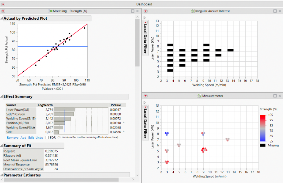

Figure 6 – Building of the custom design of experiments –  The results are presented into a dashboard. The irregular shape of the weldability lobe is reminded in the top right chart. The experimental points, proposed by the Custom Design platform, and the associated strength values, in percent, are summarized in the bottom right chart. Finally, the Fit Model platform on the left displays the modeling result. An explicative power R2 of 96% has been reached, meaning that only 4% of the variations escape its predictive power. The Effect Summary shows that the main effects (laser power, welding speed and position) are significant. The side factor is not directly significant, but becomes so when associated with the position. The VIFs (Variance Inflation Factors, not displayed here) have all a value smaller than 1.6, showing no multicolinearity issue (no linear relationship among two or more explanatory variables exists).
