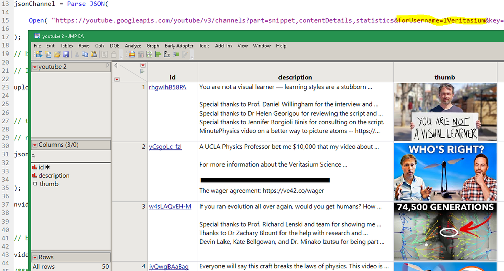

You can also search by channel name, rather than ID:
Veritasium uses 1Veritasium for the actual channel name. There is a re-direct easter egg at the other one.Veritasium uses 1Veritasium for the actual channel name. There is a re-direct easter egg at the other one.
