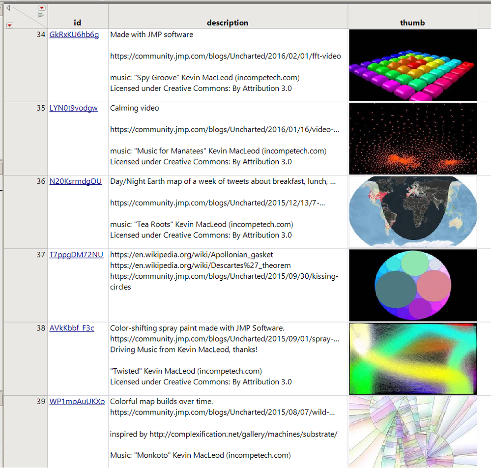

Video links, descriptions, thumbnails.Video links, descriptions, thumbnails.
JSL, attached, also adds the blue links to the ID column.
The JSL uses several APIs:
  • channels - find my channel and my channel's upload list ID.
  • playlistItems - the upload list is a playlist. Get the video IDs from that play list.
  • videos - get information about a video using its ID.
YouTube video IDs are the cryptic blue link values in the picture. The JSL is a bit silly because the information being stored in the data table was available from the playlistitems, but you might be starting with video IDs that are not in a play list.
