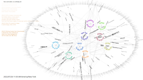

Several weeks ago I started a spring-force node-diagram project using data from Twitter. It got complicated, and I decided a video was the best way to showcase it. But, the video was long and boring. Here's an early snapshot.
Half-baked ideaHalf-baked idea
On Waffle Sunday, I asked several family members to review and suggest how to make it better. They all made good comments, but Daniel really wanted to show me something. I kept putting him off, until I began to realize my video wasn't that amazing after all.
