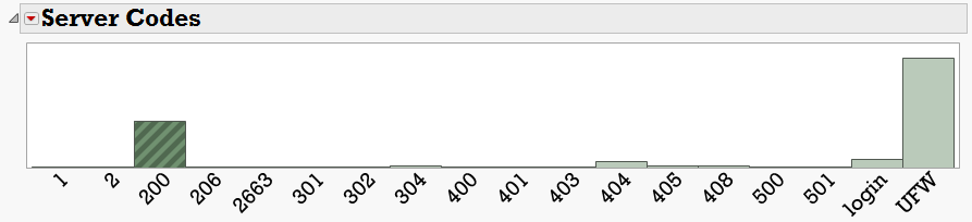

About 25% of the activity is 200-OKAbout 25% of the activity is 200-OK

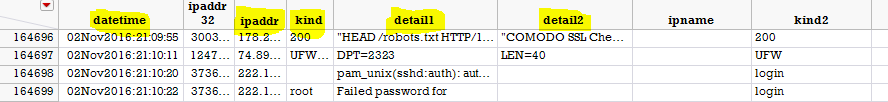

Load the data into a data table
Each of the files is formatted differently, the dates may not contain the current year, fields might have name=value or just be positional. I moved all the files from the Linux server to my windows machine and used FilesInDirectory to get a list of filenames in JSL. Then I wrote a set of patterns to efficiently parse the three types of files. The data table columns were chosen to represent the data I wanted to capture from each of the files:
Columns in tableColumns in table
ipaddr32 is a formula column to turn 1.2.3.4 into 1<<24 + 2<<16 + 3<<8 + 4 for a continuous axis on a graph. ipname will be looked up later. kind2 is a formula to reduce all the different user IDs into just "login".

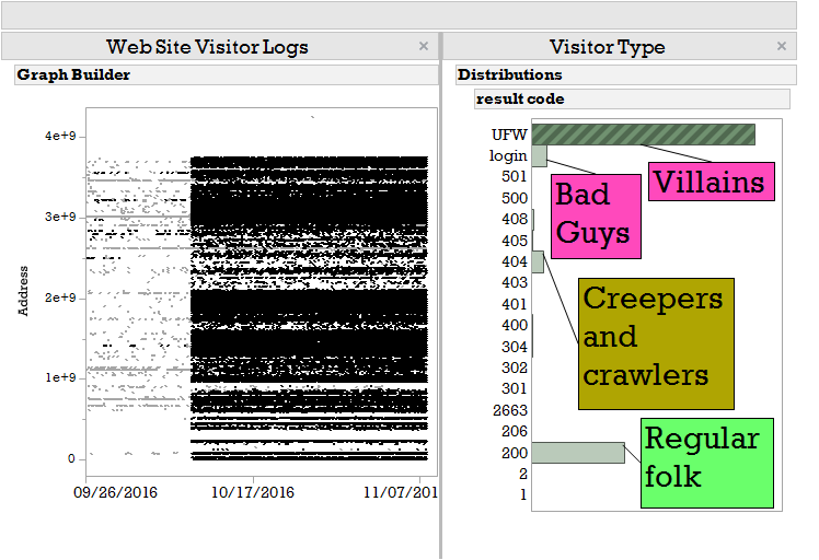

The Raspberry PI computer seems to attract a lot of attacks using username PI. PHP scripting must be mis-configured pretty often; there are a lot of checks for certain PHP "admin" files. And finding an open port that has a weakness must be really valuable; the vast majority of the attacks are testing ports. If you manage a web server and you are not using fail2ban and firewall rules (like UFW), you should consider installing and configuring them. You can slow down a brute force attack by allowing a few attemps per day instead of multiple attempts per second.
Dashboard view of web trafficDashboard view of web traffic
