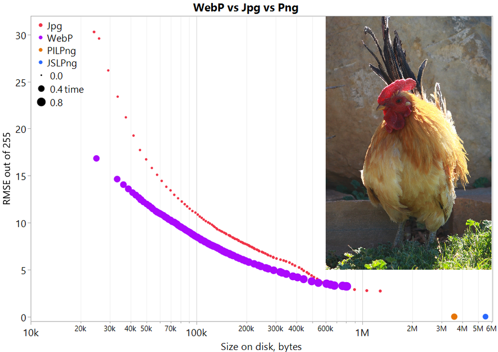

p1000000073.pngThis post shows a way-too-slow way to do ray marching and a perfectly fine Python way to make an animated WebP (like an animated Gif, but so much nicer!)
Part 1:  file formats
This JSL uses the Python PIL library to make some test files to compare size, speed, and quality of PNG, JPEG, and WebP files. GIF is in part 2. If you want to run it, use 0 or 1  on the second line to make each picture. The RMSE values are the average error of the decoded pixels minus the source pixels in 0..255 color channel units. The error gets larger with more compression and makes the artifacts or blurriness in highly compressed images. PNG images use a lossless compression that results in a 0.0 RMSE.
The purple WebP dots are pretty consistently lower RMSE than the red JPEG dots for almost all compression levels. They also take about 20X as long to compress, which might be worth it if the images will be stored forever.

Saving a real-world image. The orange and blue dots beyond a 3MB disk size show how PNG files fail to compress this data well.  The original is 1264x2208 = 2,790,912 pixels of 3 bytes each (if uncompressed.) For (almost) any file size, the WebP has a smaller RMSE (better quality) than the same size JPEG, but the time to compress (marker size) is much larger.

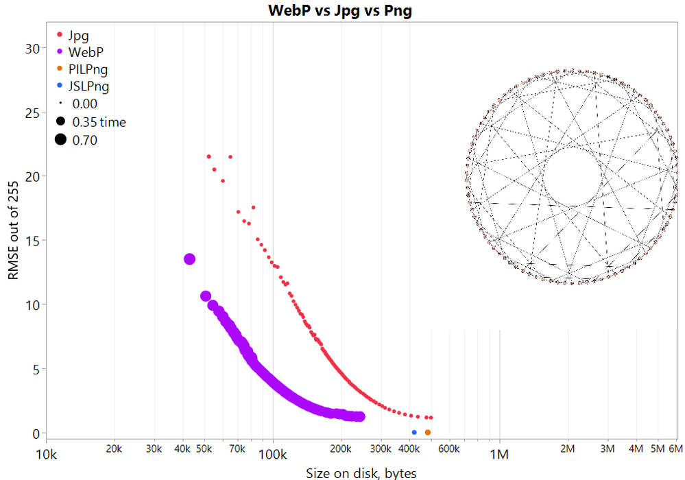

Saving a hard-edged computer image. With this data, PNG out-performs JPG for a best-quality image. However many observers will be satisfied with small RMSE values, less than 5 or so, for either image type.  The original is 2000x2000 = 4,000,000 pixels of 3 bytes each (if uncompressed.) Again, the WebP is higher quality compared to the same size JPEG but takes longer to compress.

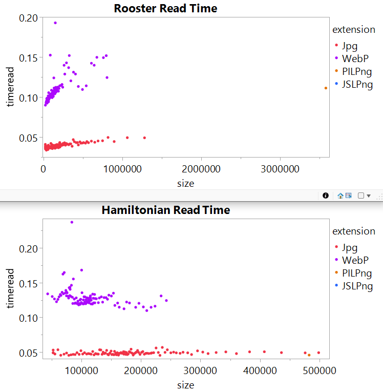

Here's a quick look at the read times; they only apply to the PIL reader in Python, not FireFox or whatever browser might be displaying the images. It looks like WebP is 3X slower than JPEG to load.
None of WebP, JPEG, or PNG are clear winners (yet. Keep reading.) JPEG compresses fast, WebP compresses small, and PNG is lossless. My personal preference is to use PNG for most computer generated graphs and (in the past, at least) JPEG for real world images. JMP 19 image support does not include WebP without using Python.

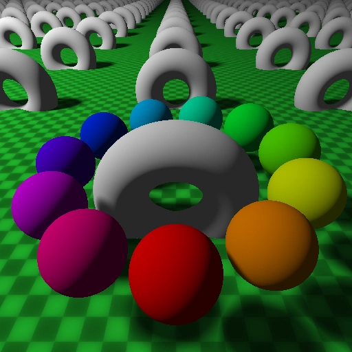

Several years ago I stumbled into https://www.shadertoy.com/ (don't look, you might not make it back for a while!) Shaders are tiny programs that run on graphics cards using the GPUs. Each pixel of the display is colored based on the output of the shader program. More GPUs generate more pixels, faster. The site is fascinating because you can modify the C-like shader program and re-run it in your browser. Your browser has access to the GPUs, and it is really fast.
The shader idea was originally intended to color 3D triangles where each corner has a color (based on material, orientation, lighting, ...) The pixels (usually called fragments) of the triangle are interpolated between the corners. However, there is no requirement that a shader use a 3D triangle; it can compute a color any way it wants. Some of the shadertoy examples compute a color based on the x-y pixel coordinates and the current time (to drive an animation, perhaps of wave-like motion in the ocean.)
The more interesting examples use an idea called ray marching. There are a lot of great tutorials on ray marching and signed distance functions. (An SDF for an object returns a positive distance from its surface unless the point has somehow gone inside, then a negative distance.) Briefly, ray marching puts a virtual screen of pixels in front of your eye/camera and follows a ray from the eye through a pixel into a bunch of signed distance functions, asking each SDF "How far is this point on the ray from you?". A sphere, cube, torus, plane, etc. all have simple SDFs. The magic of the ray march is to find the minimum answer from all the SDFs and move that far along the ray and repeat until the minimum distance is quite small. Each pixel typically requires a dozen iterations to sneak up on an object represented by an SDF. The same style of march can also discover if the point on the SDF is shadowed and what the slope of the surface is (which determines how much light bounces to the eye.)
Here's the JSL For making both the animated GIF and the animated WebP from a 3D model with a camera moving around it. The bigger part of it is the code for the ray marching; you won't need that. The functions you are looking for are addNewFrame, which makes a file in a directory from a global variable named bitmap, and saveFrames, which takes all the files from the directory and builds the WebP or the GIF. You'll want to modify them to meet your needs. Everything else is specific to the ray marching and is educational more than useful (because it is slow.)

finalImage=0; // a flag to recreate the animated gif
// if you are going to use this for more than a simple gif-loop,
// you could repackage this. For now it uses an "time" from 0 to 1
// to make a complete orbit of the camera. Shadertoy uses time "t"
// and makes an angle from that; shadertoy is not typically making
// a loop for a gif, but rather a mouse driven display.
// using a power of 2 is not required for the step but does make the
// begin and end match up; the <1.0 means the end frame is left out.
for(time=0.0,time<1.0,time+=1/nframes,
	// y rotation (vertical on screen) is done over the angles. then
	// a small tilt on X to make the camera look down at the tiled floor.
	// then the camera is pulled back so the scene, which is near 0,0,0
	// will be in view. Back means the Z axis; the wording around this
	// is always confusing!
	angle = time*2*pi();
	anim_8=8*angle;
	anim_7=7*angle;
	anim_3=3*angle;
	anim_1=1*angle;
	camera = tranmat(0,0,-8)*getXrot(-.1 *2*pi()+0.06*sin(anim_1))*getYrot(anim_1);
	// the scene list is a list of lists... and the lists must be evaluated to store an efficient value.
	scene = Eval List(
	// tranmat: Y positive down screen, z positive toward camera
		Eval List(
			{"torus", Expr(
				ptrep = pt[1]-12*round(pt[1]/12)||pt[2]-12*round(pt[2]/12)||pt[3]; // repeat the torus on the X and  Z axis (rotated onto Y)  https://iquilezles.org/articles/sdfrepetition/
				sdTorus( ptrep, [2 1] );
			), Eval List( {"solid", RGB Color( "white" )} ), //
			Inverse( scalemat( 1, 1, 1 ) * tranmat( 0, 1/*down to the floor*/, 0 ) * rotmat(90,0,0))}
		Eval List(
			{"floor", Expr(
				sdPlane( pt, [0 -1 0], 2.1 )
			), Eval List( {"checker", RGB Color( "green" )} ), //
			Identity( 4 )}
	nspheres = 11;// add n bouncing spheres in a circle. the Y axis anim8 + p0 phases the bounces
	for( p=0,p<nspheres*1.00000001,p+=1,
		p0 = (p/nspheres)*2*pi();
		scene[nitems(scene)+1] =
		Eval List(
			{"sphere", Expr( sdSphere( pt, 1 ) ), Eval List( {"solid", hlscolor(p0/(2*pi()),.5,1)} ), // color based on p0
			Inverse( rotmat( 0, 0, 0 ) * scalemat( 1, 1, 1 ) * tranmat( 4*sin(p0), -(1.5+sin(anim_8+(p0)))*0.25, 4*cos(p0) ) )} // and position and height
	// choose your pain level; double the x and y is 4 times as long
	bitmap = J( xypix, xypix, 0 );
	//bitmap = J( 32, 32, 0 );// ~3 seconds for a single image
	//bitmap = J( 64, 64, 0 );//
	//bitmap = J( 128, 128, 0 );//
	//bitmap = J( 256, 256, 0 );// 6 min/image
	//bitmap = J( 512, 512, 0 );// 35 min/image
	//bitmap = J( 1024, 1024, 0 );//
	// JSL's parallelassign function assigns a value to each element of an
	// array, using your multiple CPU (not GPU) processors. Each CPU thread

GIF - 12MB WebP - 10MB
The ancient GIF image compression produced a 20% larger file with severe color banding. The WebP looks great. The torus has one SDF, repeated at very low cost. The colorful spheres each have a separate SDF, and the tiled floor has an SDF. The floor tiles fade into the distance to avoid twinkling alias artifacts. The soft shadows combine two shadowing ideas. The lighting is fixed to the model, and the light and the model are rotating in front of the camera. The spheres are bouncing without ever quite touching down to the floor. The camera angle changes to show the sky during part of the rotation.  The GIF was produced by JMP's GIF writer, not PIL's GIF writer. There are a lot of ways to optimize a GIF; JMP and PIL will make different choices for different images.
I'm not planning to do anything else with the ray marching code because it is way too slow without a compiled program running on GPUs. If you really needed it, you might get a 10X improvement by leaving out the shadows, simplifying the floor, and calculating the surface normals for simple primitives directly (without using four additional marches.) You'd still be looking at minutes/frame, not frames/second.
