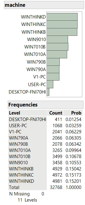

The distribution of work across the machines in the farm after 55 hours:
Several classes of hardware in this Beowulf Cluster.Several classes of hardware in this Beowulf Cluster.
The counts represent the number of images each machine created. Each time a machine finishes an image, it asks the Number Server what image it should work on next. Because the raindrop positions are precomputed, and the zoom level is determined by the image number, all the workers in the farm are able to work independently, shoving completed images into a shared folder where they get sorted by their names when the video is assembled. The code is currently set up to make the images in reversed-bit order, generating the middle image, then the 1/4 images, then the 1/8 images ... in the sequence. At the 27 hour mark, every other image has been made, making it easy to see an overview. (Sadly, the problem that required a 3rd 55 hour run could only be seen on adjacent images...sometimes...flickering raindrops!)
