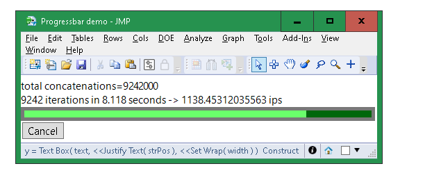

Progress Bar  showed how to make a progress bar. @abmayfield  question in "not responding" vs. "still thinking"  prompted me to revisit this. Here's another take, including a cancel button.
not cancelednot canceled
Cancel button pressed.Cancel button pressed.

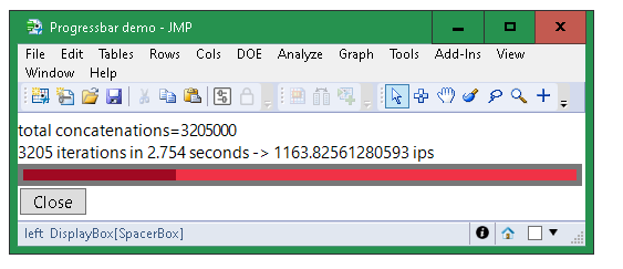

If( cancel, // test the cancel flag
	Beep(); // audio flag
	left << color( "dark red" ); // visual flag something is awry
	right << color( "red" );
	updateProgress( 1.0 ); // people like to see the bar go to 100%
cancelButton << setbuttonname( "Close" ); // visual flag the button function is changed
cancelButton << setscript( (cancelButton << closewindow) ); // and what to do if the button is pressed

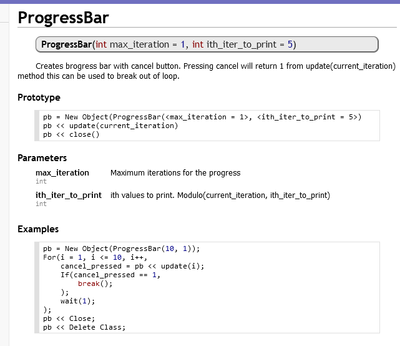

Edit: if JMP is running a platform that does not have its own cancelable progress bar, and it runs for a long time, this is not going to help. Tech Support would be a good place to request the platform support for a progress bar. Without it, there is no way (short of forcibly closing JMP) to stop it until it is done.
