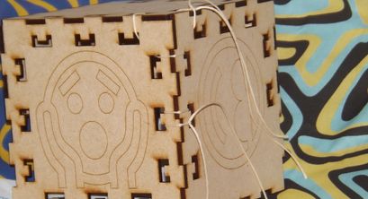

A pattern cut with a laserA pattern cut with a laser
