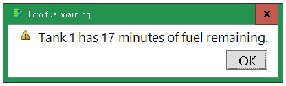

Item 1, build the tree, is often done as the argument to the New Window function. Items 2 and 3 are the New Window function. Here's an alert box modal dialog.
rdata = New Window( title, <<modal, H List Box( Icon Box( icon ), Spacer Box( size( 10, 1 ) ), V Center Box( Text Box( text ) ) ) )
<<modal is the magic that makes this be a modal window that waits for the window to close before executing the next statement.
Just thought you should know...Just thought you should know...
This little window's two-way dialog is very simple:
  • JMP: "Wake up! This thing happened!"
  • You: "OK"
There is no data to return. The New Window function does return a value; it tells if you pressed the OK button
{Button( 1 )}
or closed the window with the OS-provided close button
{Button( -1 )}
It is returning a list with one element. You could test for Cancel vs OK using rdata["Button"] which will be -1 or 1. You probably don't care since you didn't put a CANCEL button in the dialog.
View more...
Not only do you need to supply the title and text, you need an icon. I like the addin for built in icons for a quick project like this. You can make custom bitmaps too, if you need them. @Justin_Chilton  Built-In JMP Icons
The "Error" icon might not exist on the Mac.The "Error" icon might not exist on the Mac.
or a warning icon of a different size
warning!warning!

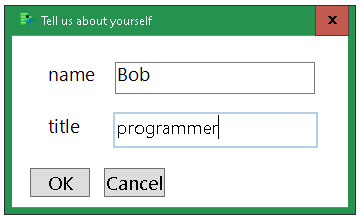

All of the examples above return a list. The items in the list all look like simple assignment statements or some kind of function call. A little used, poorly understood feature of JMP is subscripting lists using those names, rather than the more usual numeric index.
result = New Window( "Tell us about yourself",
    <<modal,
    <<return result,
    V List Box(
        Lineup Box( N Col( 2 ), spacing(20),
            Text Box( "name" ), name = Text Edit Box( "", <<SetWidth(200) ),
            Text Box( "title" ), title = Text Edit Box( "", <<SetWidth(200) )
        H List Box( Button Box( "OK" ), Spacer Box( size( 10, 1 ) ), Button Box( "Cancel" ) )
Bob is about to press OKBob is about to press OK
The value in result might be
{name = "Bob", title = "programmer", Button( 1 )}
or, if Bob cancels,
{name = "Bob", title = "programmer", Button( -1 )}
If( result["Button"] == 1,
    Write( Eval Insert( "\!n\[^result["name"]^ is a ^result["title"]^]\" ) )
, // else
    Write( "\!nthe dialog canceled." )
Bob is a programmer
The list does act a bit like an associative array, though it is done with a sequential lookup. (If you need an associative array, make one. Don't use this list behavior...it is a poor substitute.)

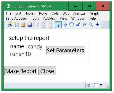

When your user presses the cancel button on a modal dialog, they expect nothing to be changed. Any JSL in a modal dialog should be operating the dialog without making changes to variables in the rest of your program. Here's a bigger example; it has a modeless dialog for launching reports:
You can work in other windows while this window is open; it is a modeless dialog.You can work in other windows while this window is open; it is a modeless dialog.

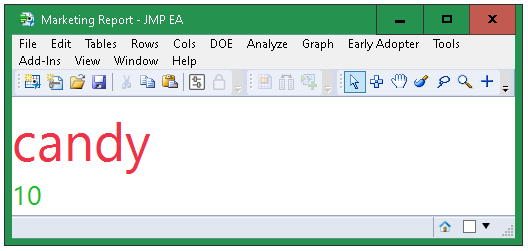

Each time you press the Make Report button, another window opens:
A report showing the values from the modeless launcher.A report showing the values from the modeless launcher.

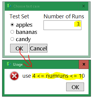

There is also a Set Parameters button that opens a modal dialog with a validation routine. This cancel button will not apply any changes to the launcher above.
The validation routine opens yet another modal dialog.The validation routine opens yet another modal dialog.

// here's a simple modal window. It provides a warning, but no data is returned.
alert = Function( {title, text, icon = "error"},
// alert( "Clock says", "time is running out!", "Warning" ) // the error icon (default) looks better
testNames = {"apples", "bananas", "candy"}; // names of the radio buttons
testIndex = 3; // selected radio button is "candy"
numberOfRuns = 10; // value for Number Edit
// this function opens a modal dialog with current values and validates them and sets the testIndex and numberOfRuns
chooseNamesAndRuns = Function( {title, lo = 5, hi = 10}, // parms for validation
	{ex}, // local variable
	ex = New Window( title,
		<<modal, // modal means JMP must wait for an answer
		<<On Validate( // the window wants to close; validate settings
			If( lo <= (numberOfRunsResult << get) <= hi, // validation
				1; // all good, return 1 to dismiss window
			, // else something is wrong
				alert( "Usage", Eval Insert( "use ^lo^ <= numruns <= ^hi^" ) ); //
				0; // return 0 to keep window open
		<<Return Result, // the keyword that makes the modal window return values from the displaybox tree
		V List Box(
			H List Box(
				V List Box( Text Box( "Test Set" ), testIndexResult = Radio Box( testNames, <<set( testIndex ) ) ), // return testIndexResult
				Spacer Box( size( 20, 1 ) ),
				V List Box( Text Box( "Number of Runs" ), numberOfRunsResult = Number Edit Box( numberOfRuns ) ) // return numberOfRunsResult
			H List Box(
				Button Box( "OK" ), //
				Button Box( "Cancel" ) //
    // because of modal, the window must be dismissed with OK or CANCEL before the next statement is executed.
	// now, ex is a list:
	//    {testIndexResult = 1, numberOfRunsResult = 43, Button( 1 /*OK*/)}
	//    {testIndexResult = 2, numberOfRunsResult = 44, Button( -1 /*CANCEL*/)}
	If( ex["button"] == 1, // 1 is for the OK button, -1 is CANCEL. If OK, copy values back...
		numberOfRuns = ex["numberOfRunsResult"]; // only update the application's numberOfRuns and testIndex
		testIndex = ex["testIndexResult"]; //       if OK is pressed. CANCEL does nothing.
// this modeless dialog sets up reports. It has a button to
// open a modal parameter dialog and a button to make reports.
app = New Window( "our application",
	V List Box(
		Panel Box( "setup the report",
			H List Box(
				V List Box( // stack these to the left of the button
					H List Box( Text Box( "name=" ), nb = Text Box( "" ) ),
					H List Box( Text Box( "runs=" ), nr = Text Box( "" ) )
				V Center Box(
					Button Box( "Set Parameters", // launch a modal dialog
						chooseNamesAndRuns( "Choose test case", 4 ); // title, min=4, max is default, see function
						syncNames(); // re-sync variables that changed into the window
			<<margin( 9 ) // add space around the "setup" panel
		H List Box(
			Button Box( "Make Report", makereport() ) //
			Button Box( "Close", app << closewindow ) // modeless dialogs don't have OK/Cancel; here's one way to close
// this function synchronizes our applications display with the current data
syncNames = Function( {},
	nb << settext( testNames[testIndex] ); // nb is the name text box
	nr << settext( Char( numberOfRuns ) ); // nr is the number of runs text box
syncNames(); // initial display. Note the values were set to "" in new window() and need an initial sync.
// a minimal placeholder; open a new window containing a report built from parameters set above
makereport = Function( {},
	New Window( "Marketing Report",
		V List Box(
			Spacer Box( size( 500, 1 ) ),
			Text Box( testNames[testIndex], <<Font Color( "red" ), <<Set Font Size( 40 ) ),
			Text Box( Char( numberOfRuns ), <<Font Color( "green" ), <<Set Font Size( 20 ) )
