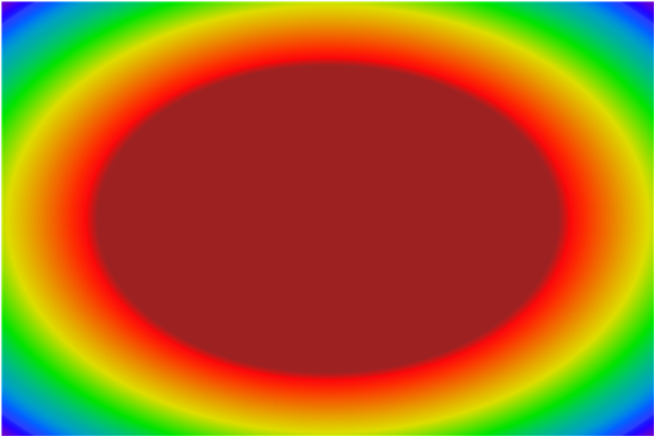

Also notice the right hand side of the matrix assignment can be more complicated.
m=J(400,600,0);
parallelassign({},m[r(-1,1),c(-1,1)]=(
    z=sqrt(r^2+c^2);
    z=if(z<.707,.707,z)-.5;
    1-z; // last item in ; sequence is result
m=m/max(m); // for heat color
newwindow("example",newimage(heatcolor(m,"spectral")));
"z" only exists inside each of the threads, a separate copy for each.
That flat area, dark red, was created by the if statementThat flat area, dark red, was created by the if statement
