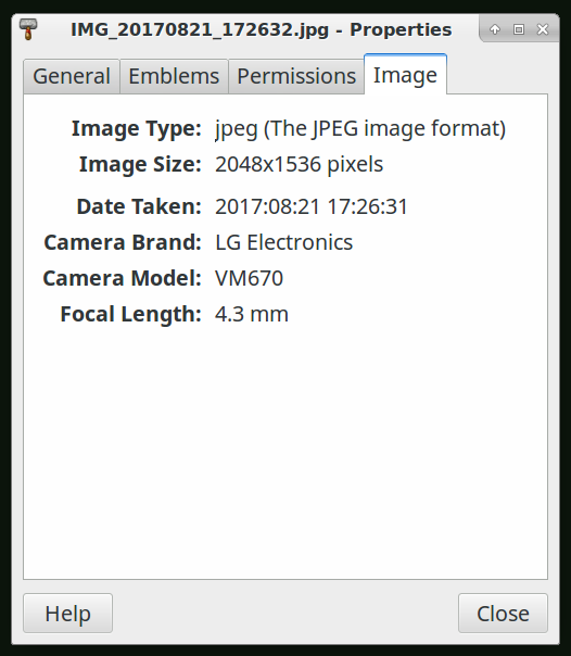

The smooth sand in front of that tripod is where we hope to catch shadow bands. When we got back to North Carolina (the trip home was also an adventure!) I opened one of the images in the Linux file manager and was disappointed:
Thunar is a file manager for LinuxThunar is a file manager for Linux

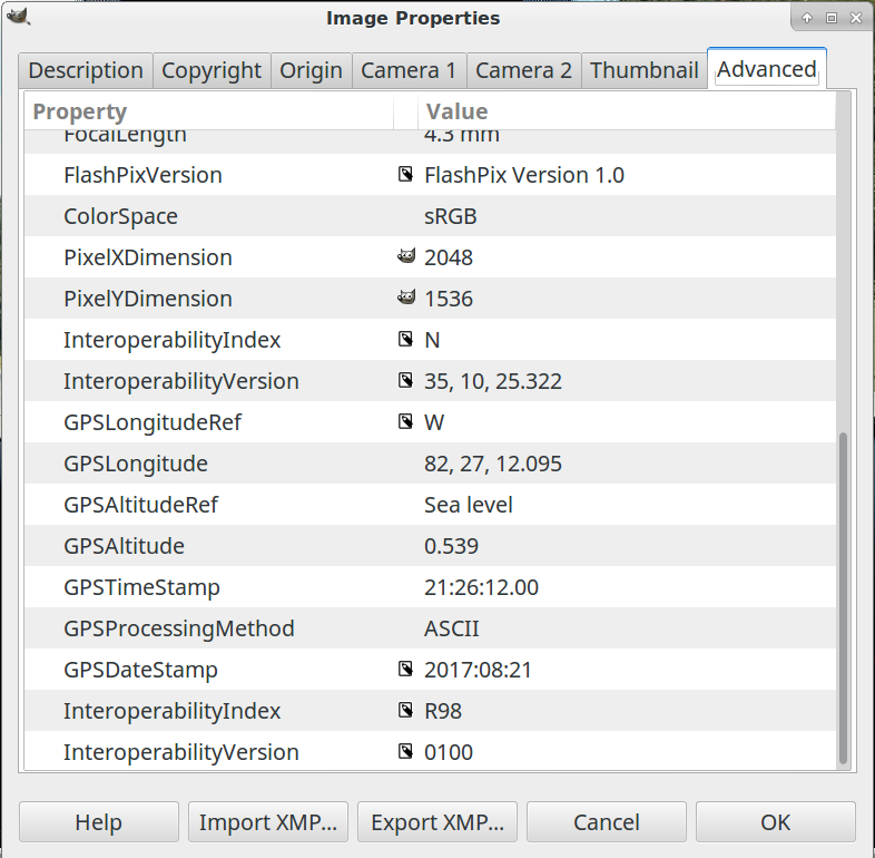

No interesting data. Next I tried GIMP, and was again disappointed:
Gimp is an image editing programGimp is an image editing program

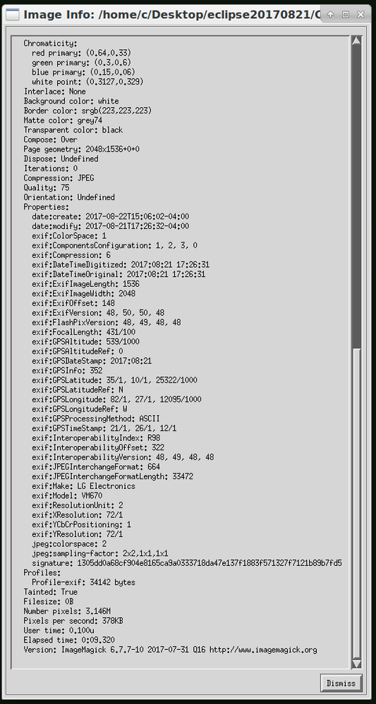

I now know the answer is there, but it is labeled wrong for the Latitude. Next I tried ImageMagick, and got close, but with some odd representation:
ImageMagick is another image processing programImageMagick is another image processing program
Now I'm close, there are nicely labeled values for both Latitude and Longitude, but what do they mean?
Lat: 35/1, 10/1, 25322/1000
Lon: 82/1, 27/1, 12095/1000

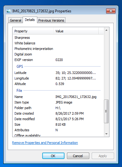

If I look at windows properties, I get a fairly clear answer, but still not in a useful format.
Windows also displays lat/lon in the properties dialogWindows also displays lat/lon in the properties dialog
I think different cameras may use slight variations of the idea, but the answers above are showing degrees, minutes, and seconds. Google and JMP just use degrees with a lot of fraction after the decimal. So the answer for this picture
Welcome sign at NC borderWelcome sign at NC border
is computed as degrees + minutes/60 + seconds/3600. For the ImageMagick representation, it looks like
Lat: 35 + 10 / 60 + (25322/1000) / 3600 = 35.173700556
Lon: 82 + 27 / 60 + (12095/1000) / 3600 = 82.453359722
