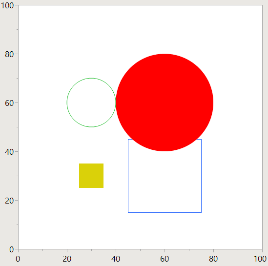

Moving on to the final example, let's do some subclassing and look at the last namespace, super:, which I had to hunt for (see comments in JSL).
Intuitive example: a base class might be a vehicle, subclasses (or derived classes) are trucks and cars. A truck might replace the base class navigation method with one that knows to avoid residential streets. A car might take advantage of HOV lanes. A list of vehicles will each do the right thing when told to navigate from A to B.
Define Class has an interesting argument: baseclass(...). In the example below, shape will be the base class and square and circle will be derived from shape. The example makes a list of squares and circles and displays them.
two squares, two circles, two outlined, two filledtwo squares, two circles, two outlined, two filled

Define Class( "shape", // base class for both shapes
	m_Xcenter = .;
	m_Ycenter = .;
	m_radius = .;
	m_sides = .;
	m_color = .;
	m_filled = .;
	_init_ = Method( {x, y, radius, sides, color, fill},
		m_Xcenter = x;
		m_Ycenter = y;
		m_radius = radius;
		m_sides = sides;
		m_color = color;
		m_filled = fill;
	_to string_ = Method( {},
		"shape=(s=" ||
		" x=" || Char( m_Xcenter ) || " y=" || Char( m_Ycenter ) ||
		" r=" || Char( m_radius ) || " s=" || Char( m_sides ) ||
		" c=" || Char( m_color ) || " f=" || Char( m_filled ) || ")"
	_show_ = _to string_;
	// the following should NOT ever get called because square and circle override it
	// try changing square to call super:docolor and then you'll see this
	record=method({},show("never seen, overridden by square and circle"));
	// both shapes understand filled vs outlined
	// see note in square:draw method about calling docolor without super:
	docolor = Method( {},
		this:record(); // this: doesn't change anything,
		If( this:m_filled, // it is mostly for disambiguating
			Fill Color( /*this:*/m_color );// parameter of same name
			Pen Color( this:m_color )
	// the base class has a draw method that circle uses;
	// square provides an override because this draws a
	// diamond-oriented square
	draw = Method( {},
		docolor();
		p = J( m_sides, 3, 2 );//2==draw
		p[1, 3] = 1;//1==move
		p[m_sides, 3] = -2;//-2==draw and close
		For( i = 1, i <= m_sides, i += 1,
			p[i, 1] = m_Xcenter + m_radius * Cos( 2 * Pi() * i / m_sides );
			p[i, 2] = m_Ycenter + m_radius * Sin( 2 * Pi() * i / m_sides );
		Path( p, m_filled );
Define Class( "circle", baseclass( shape ),
	_init_ = Method( {x, y, radius, color, fill},
		super:_init_( x, y, radius, 99/*sides*/, color, fill )
		"circle(" || super:_tostring_() || ")"
	record=method({},write("\!nrecord circle=",_show_()));
	// circle has no override for draw()
Define Class( "square", baseclass( shape ),
		super:_init_( x, y, radius, 4/*sides*/, color, fill )
		"square(" || super:_tostring_() || ")"
	record=method({},write("\!nrecord square=",_show_()));
	// square overrides the base class draw
	draw = Method( {},
		/*super:*/docolor();// don't up-cast, docolor can't down-cast and gets base class record()
		Rect(
			m_Xcenter - m_radius,
			m_Ycenter - m_radius,
			m_Xcenter + m_radius,
			m_Ycenter + m_radius,
			m_filled
objects = {};
Insert Into( objects, New Object( square( 30, 30, 5, "yellow", 1 ) ) );
Insert Into( objects, New Object( Circle( 30, 60, 10, "green", 0 ) ) );
Insert Into( objects, New Object( square( 60, 30, 15, "blue", 0 ) ) );
Insert Into( objects, New Object( Circle( 60, 60, 20, "red", 1 ) ) );
New Window( "objects",
	gb = Graph Box( framesize( 500, 500 ),
		For( window:i = 1, window:i <= N Items( objects ), window:i += 1,
			//Show( objects[i] );
			objects[window:i] << draw(); // uses the base class or the derived class draw
//stop();
// animate the color of object 4, the big red circle
For( i = 0, i <= 1, i += (1 / 256), //show(i);
	objects[4]:m_color = HLS Color( i, .5, 1 );
	gb << inval << updatewindow;
	Wait( 0 );
