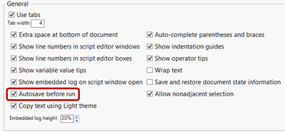

I really love the setting AutoSave before run.
- during JSL debugging I can be sure that the JSL code is saved every few minutes (with every trial to make it run)
- saving the JSL files in the cloud allows me to get previous versions of the code - just in case the last version was not OK ...
