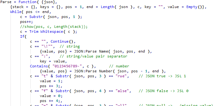

Xan's original code has a parsing routine to read the JSON string a character at a time:
the variable pos walks through the length of the string, to end, one character at a time.  The real magic in Xan's code is in the handling of the [, ], {, } characters.  I just copied the magical parts into the replacement code.  Above, you can see the handling for quotation mark, colon, t, f.  Those characters direct the parser's handling of subsequent characters.

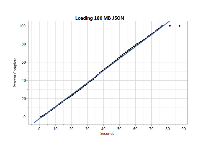

With these changes and a change Xan suggested to replace a slow insertion at the end of a list with a fast insertion at the beginning of a list, JMP loads 180MB of JSON data in 90 seconds (vs .25MB in 5 minutes), an improvement of 1000X.  Better, maybe, since it might be linear with file size now.
