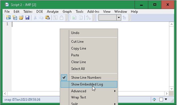

I use the embedded log a lot:
Right-click to get the popup.Right-click to get the popup.

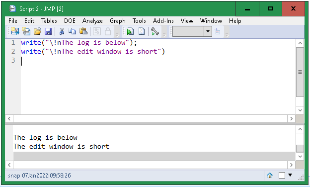

The code editor is shortened, top-to-bottom, and the log is quite wide:
I'd like more vertical space in the upper editor.I'd like more vertical space in the upper editor.
Run this and it is fixed!
(Current Window() << child) << sethorizontal( 1 );
A narrow log is fine; usually I'm just watching for an error message.A narrow log is fine; usually I'm just watching for an error message.
