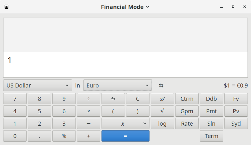

The currency buttons on the Linux calculator caught my attention recently.
Calculator showing the currency conversion buttonsCalculator showing the currency conversion buttons

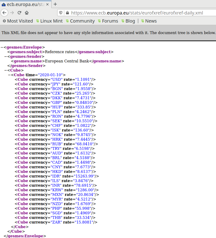

How do they get up-to-date conversion factors? Google took me here, which took me here, which took me to this European Central Bank page containing the rates and a link to PDF, CSV, and XML downloads. Click the XML link and your browser will probably open something like this:
screenshot of FireFox showing an XML file of exchange ratesscreenshot of FireFox showing an XML file of exchange rates

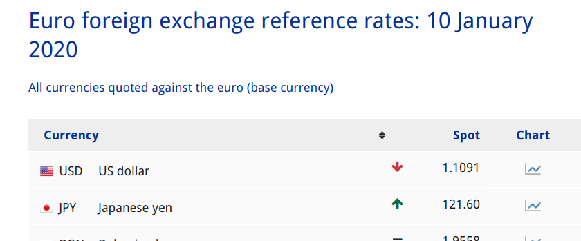

A quick look suggests these rates are all based on the Euro, because the Euro does not appear and there is no 1.0000 factor in the table. That's also what the referring page said:
based on the eurobased on the euro

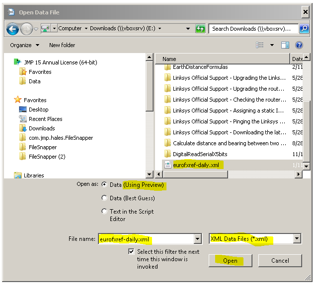

Let's load the XML into a data table. JMP 15's XML Wizard can help build the JSL to do this. First, save the XML from the browser to your machine, then use File->Open, pick the XML extension, select your file, and open it in the wizard.
Choose the XML extension to see the downloaded fileChoose the XML extension to see the downloaded file

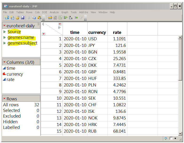

There are three other columns of meta-data: time, name, subject. Time seems most useful; let's keep the time on every row. The name and subject should only be kept as table variables; they will show up after OK:
The source script and the two table variables are part of the imported tableThe source script and the two table variables are part of the imported table
Click the table variables to be reminded where the table came from.
To reproduce this import next week, with the current data from next week, grab the source script and edit in the URL:
