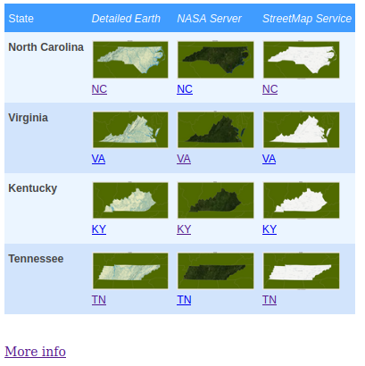

Recently I needed to do some web scraping to figure out parts availability. I used JMP to sift through the data and make a web page. This JSL is a simplified version of that web page generator. It creates an HTML directory in your computer's $TEMP space and adds some graphics using JMP's maps. At the same time, it builds a data table with links to the images.
Clicking the link in the data table opens another window; the table is moved back in front for this illustration.Clicking the link in the data table opens another window; the table is moved back in front for this illustration.
To make a web page that looks pretty, I went to a randomly selected online table generating site, did some color customizations, and grabbed the sample CSS and HTML to paste into the JSL. After a few minutes of studying, I cut it apart so the repetitive table body lines can be created from JSL. You can run the JSL unchanged and it will open a browser to the file-based site in your temp directory, or you can see it here.

It is a picture of links, not actual links.It is a picture of links, not actual links.
