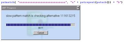

At this point it should be clear why this match runs for a very, very long time:
while you can see it can't possibly succeed because the string of aaaa...aaa has no b anywhere, the matcher has to discover that by trying lots of silly combinations: skip 2 characters followed by skip 3... and skip 3 followed by skip 2... etc, etc, etc.... Backtracking can't fix a badly written pattern. That progress bar does not mean it is almost finished. (There is no reason to put the patarb inside the patrepeat, except to see this dialog. Patarb already matches an arbitrary number of characters.)
