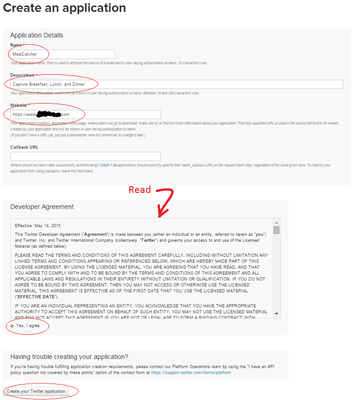

Using your Twitter account, use https://apps.twitter.com/ to create a new application.  This is NOT an app like a cell phone has.  It is a set of keys that lets a program access the Twitter stream.  That program might be an app on a cell phone, or it might be JSL, or a Python program like http://www.tweepy.org/ provides.  (I started with tweepy and then went down the JSL path.  Tweepy, or another python based solution might be better than this JSL solution.)
Click New to make a new application, make up a name no one else has used, add a description, fill in your web site name and leave the callback URL blank.  You have to supply a web site name, but, as it suggests, you can use a placeholder.  Read the agreement, then Click Create Twitter Application.

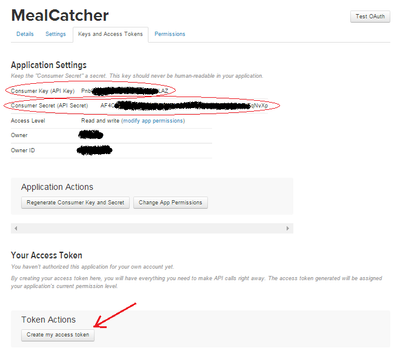

You landed on a screen with tabs; the third tab, Keys and Access Tokens, is the one you want.
At the top you’ll find part of what you need, the Consumer Key and Consumer Secret.  You’ll need the consumer key and secret.  Go ahead and start your JMP project; there will be several files, so make a directory, unzip the JSL files, and edit EncryptedKeys.JSL and start filling it in:

Click the button Create my access token at the bottom to get the last two values.
Copy them...Access Token is all on one line with a hyphen...
accessToken = "3…………………………-………………………………………………am";
accessTokenSecret = "rc………………………HJ";

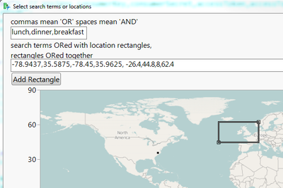

This snippet of JSL picks query terms and geographic locations.  Because the code was getting complicated, I started using namespaces:
include(“PICK.jsl”);
PICK:trackParm = "lunch,dinner,breakfast"; // default query
PICK:pick(); // GUI to adjust query
The Add Rectangle button added two rectangles.  The values in the PICK namespace will be used later to build the twitter query.  There is small amount of “and” capability; eat lunch, eat dinner, eat breakfast could be used to select tweets containing both “eat” and a meal.  But mostly everything is ORed (union).

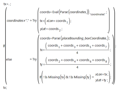

After capturing the breakfast/lunch/dinner tweets for a while, there’s enough data to make a video.  Using ideas from several recent posts…  For want of a better color coding standard, use green for starting the day and red for stopping the day and blue for lunch time.  Subset the rows to keep just the ones with location data.  I used a formula to create xLon and yLat columns from either coordinates or the center of placeBounding_boxCoordinates:
The formula sets the value to missing if the coordinates are not available; only about 5% of the tweets have coordinates.

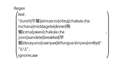

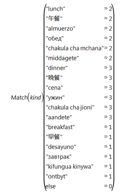

This column formula made a column to categorize the tweets, but still different for each language:
Followed by this column formula to combine categories:
