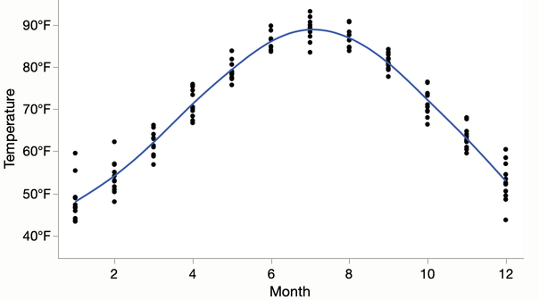

Graph axes have long supported custom label formats, which are JSL expressions that can produce arbitrary axis labels. Here's an example that adds "°F" to the y-axis labels.

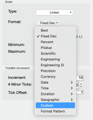

I made it by picking Custom as the Format in the Axis Settings dialog.

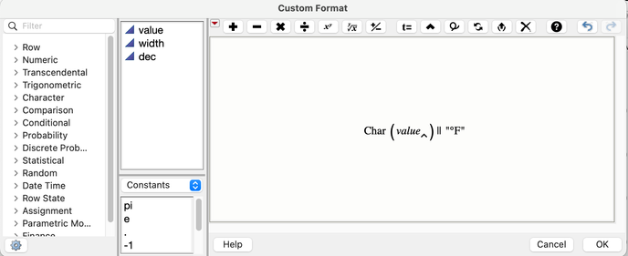

And then clicking "Custom Format" to bring up a version of the Formula Editor to create this simple formula.

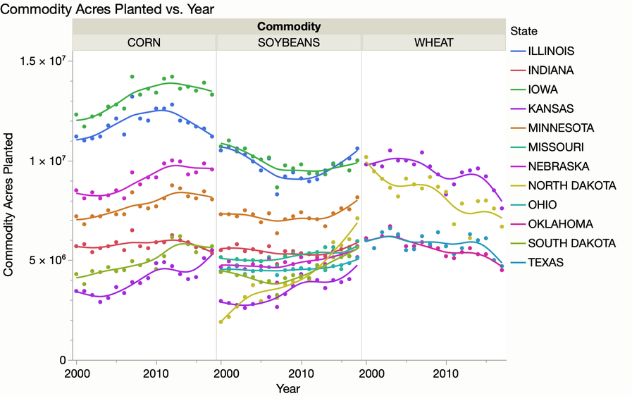

Here's a graph using that format.
Finally, here's the entire script for the graph, with the custom format as a part of the axis customizations and data filter to just show the top states.

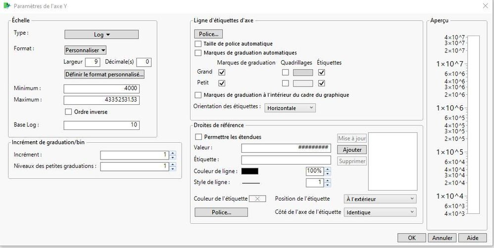

With the help of the forum, I obtained this presentation to my Anova graphic.
I used this formula:puissance2.JPG
But as you have shown, I would like to remove the "^" and have the last number in the exponent. But I do not understand, as I am a JMP beginner, how to implement your superscript. Could you explain it to me step by step?
Thanks in advance

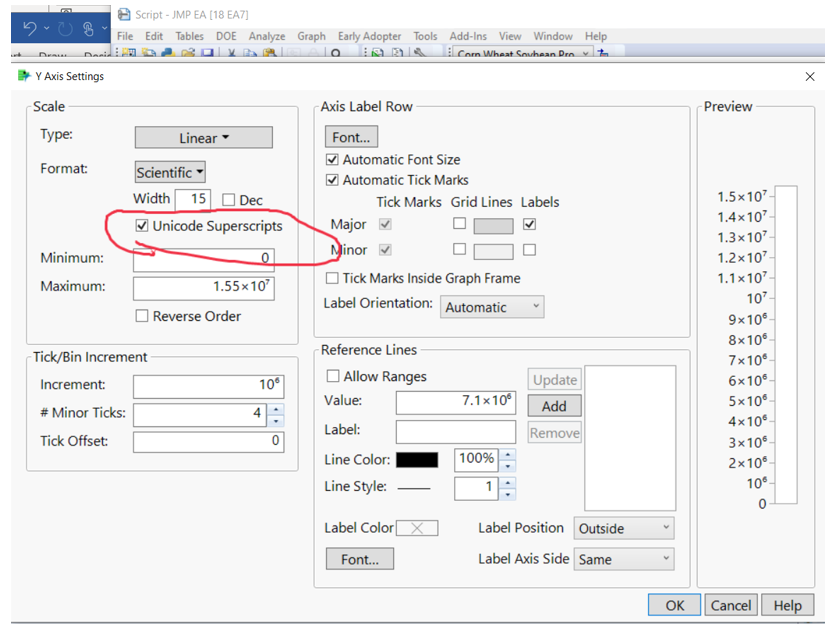

@Emmerich38 The whole reason to separate the parts is to make the second part out of the superscripted version of the characters. That’s basically what this is doing.  So, your statement while simpler, doesn’t fit easily into the current paradigm of superscripting in JMP. JMP can replace with the superscript equivalent character (in Unicode format) but it’s not doing the superscript like a word-processing software like MS-Word would do. Fortunately, in JMP 18, JMP should display the scientific notion format the way you want (with the checkbox option 'Unicode Superscripts' under the Scale group in Y Axis Settings) so there shouldn’t be any need to do any of this with custom JSL.  I hope that helps!
