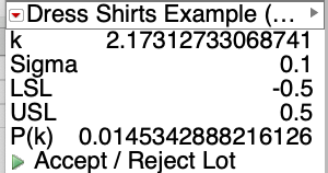

Create ( Generate ) / Compare to either develop a new sampling plan or to make distinctions and comparisons amongst several different possible sampling plans. Select generate collection table from the red triangle menu option and then after you've collected data according to your variables plan, you will determine the statistics using those measurements. The collection table will be generated with the appropriate number of observations or rows in the data table for you to use.
Accept Reject Lot Determination from JMP collections data table
Just press the green Accept / Reject icon from the collections JMP data table to perform the necessary calculations and make a determination about the batch your sample came from.
One thing to remember about variables sampling plans is that only one measurement can be examined per sampling plan. So if you need to assess the length of sample handles on the coffee mugs, as well as, their performance ( how well they retain heat or keep your beverage cold ), two separate sampling plans are required. However, variables sampling plans require much smaller sample sizes than attributes plans.

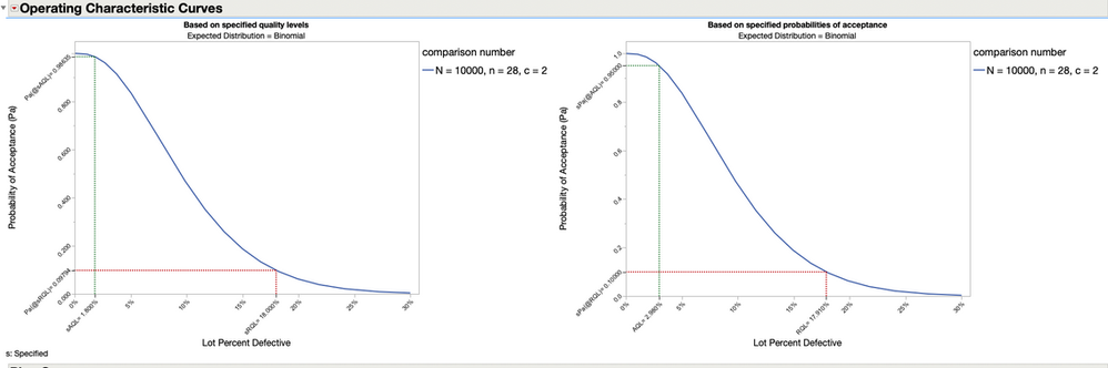

When you use JMP for acceptance sampling, the software produces many graphs.  One of the graphs produced are operating characteristic curves (OC curves) to quantify these risks. The OC curves illustrates the probability that a lot containing a certain fraction of defects or defective items will be accepted. The OC curves in the JMP sampling plan are shown based on both specified quality levels and specified probabilities of acceptance.

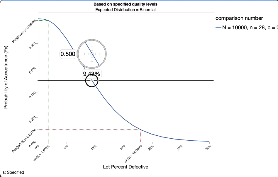

In the graph on the left which is based on the specified quality levels and a sample size of 28 items, using the crosshairs tool we can visualize there's a 50% chance of accepting the batch when 9.43% of it is defective.
Crosshairs tool showing 50% probability of acceptance
Similarly, if the percent defective is 18% or (RQL), there's only a 9.79% chance of accepting the batch.
