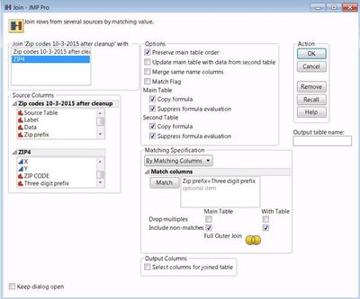

  13. If you now do Tables > Join and match by the two 3 digit prefix variables, you should have the street, city, state, and zip variables all together. I used these settings to join. Note the matching columns, and Include non-matches checkboxes for both tables.

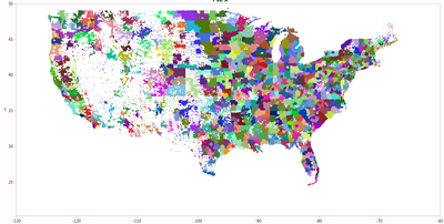

I used the steps above to add city and state info into my ZIP4 data table containing the 9 digit zip codes I imported from the SAS support site and graphed the X and Y coordinates:
(here you go Byron​! )
