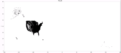

After you run the script to generate the table and save it, you can drag the X and Y to the drop zones in graph builder to see the locations of the zip codes.  They’re so dense that they largely show up the shape of the country!
The imported table is ~16.6 M rows and 14 columns. My final table was still half a gig when trimmed down to just the 5 columns I needed.

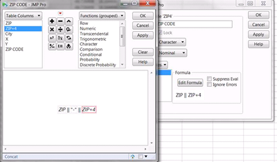

However, if you need a column in the format of XXXXX-XXXX because that’s the format your data table has the zip codes in, then you can do the following to the table you just imported.
  • Right click on the blank column at the right of the table and choose New Columns…
  • In the dialog that pops up, name the new column ZIP CODE, and under the Column Properties pulldown, choose Formula. This opens JMP’s formula editor.
  • Click on ZIP in the column chooser under the Table Columns pulldown, then choose Character in the column selection box under the Functions section and choose Concat from the popup list.  Type ‘-‘ in the empty box that opens.
  • Click Character > Concat again, and with the new blank box selected, choose the Zip+4 column from the table column selection box.
  • You should see a formula like this:
Once your formula looks like the one above, click OK in the formula editor and OK again in the column dialog.  That should add a new column to your table called ZIP CODE that contains zips in the format 00601-2103. You can then join with your original data table containing zips in that format.
