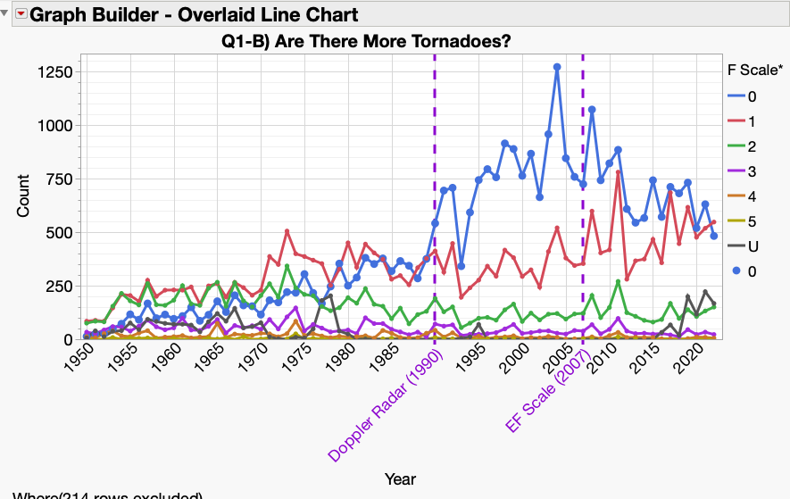

However, we can bring in an extra factor to get the third dimension.  In this case we can improve our investigation by adding the type of tornado F Scale to create an Overlaid Line Chart.  The F Scale helps us figure out the windspeed of the tornado based on the severity of the damage it leaves behind.   For example, an F2 tornado will produce winds of 113 mph to 158 mph and will leave in its path several roofless structures.  See the different F Scales below.
Screenshot 2023-06-03 at 6.16.55 PM.pngScreenshot 2023-06-03 at 6.16.55 PM.png
By creating separate overlaid graph lines by F Scale tornado type, we can see that the increase in the tornado count is due to F0 and F1 tornado types (see the blue and red lines)!  These less damaging tornado types both seem to really increase around the early 1990’s which coincides with the introduction of the widespread use of Doppler Radar.  This more advanced radar allowed for better indication and warning of tornadic activity within thunderstorms.  Now more and more F0 and F1 tornados started being reported that previously were chalked up to just strong storm wind damage.

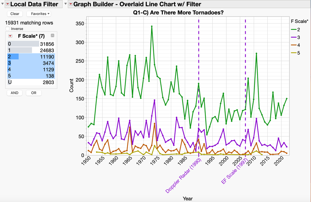

If we remove the F0 and F1 tornado type counts with an interactive filter from our graph for a fairer comparison, we can now see the true trend behavior of the more serious F2 to F5 tornadoes.  The flatter trend behavior (or even decreasing F2 activity) now leads us to the conclusion that overall tornado account is not necessarily increasing over time!
