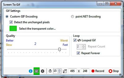

Screen to Gif is a pretty intuitive app, so I'm not including an extensive tutorial here, however I wanted to bullet some suggestions and point out the app settings window and my recommended Gif settings. It's actually very fun to use, and if there's some interest here, I'll make a tutorial video if that helps, please request that in comments below.

  • Choose lower settings at first, using the Lower Settings Image icon to adjust (shown below)
  • Set your destination folder, "Save Directly to Folder"  using the Lower Settings Gear icon to adjust (shown below)

  • My recommended Gif settings: Quality 2-4, Time 7-10 secs, 10 frames per sec, size 500kb-1mb
Settings from the Lower Image Icon
