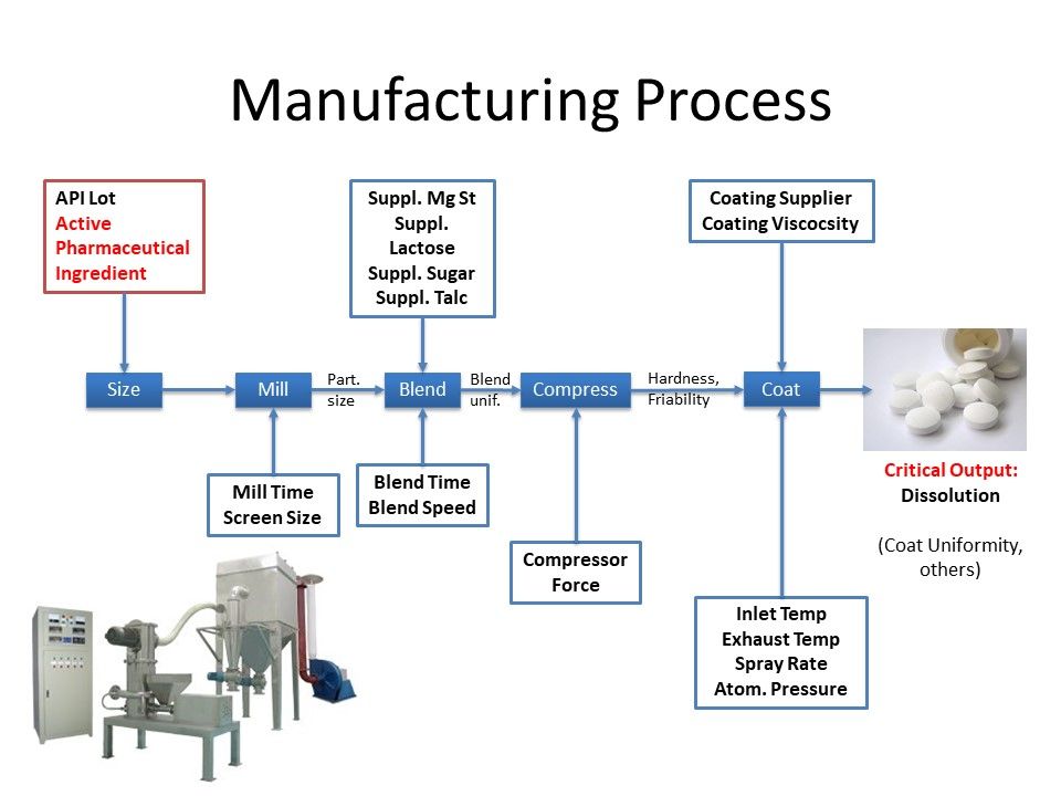

This is a schematic of the multi-stage process for producing tablets from the Active Pharmaceutical Ingredient:Tablet process.jpg

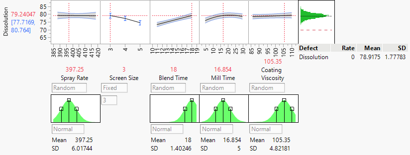

They identified that just a handful of the process variables were important drivers of variation. A statistical model showed them how to control the process to consistently produce quality product:
