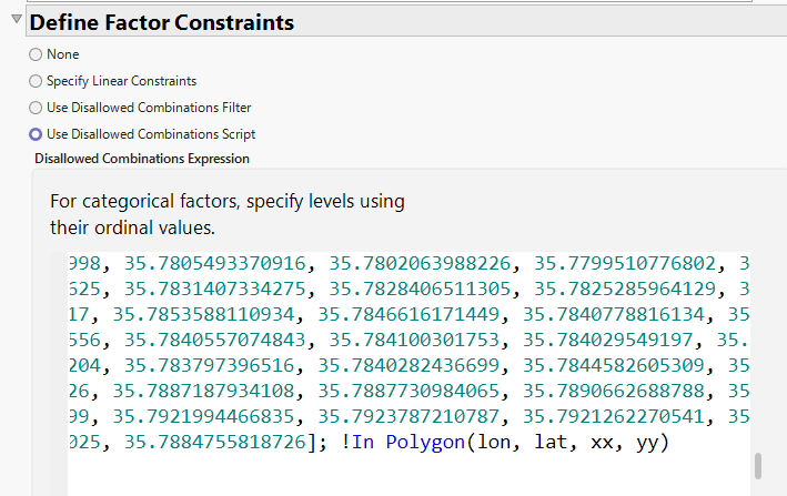

  3. [スクリプトで許可しない組み合わせを指定]で東京都の領域外を除外

How did you specify the disallowed combinations?  Did you define the boundary of Tokyo as a polygon and use the "In Polygon()" function?  Very cool to be able to determine a space filling design of geo locations inside a natural  region.
Masukawa_Nao
Staff
@MathStatChem , Thank you for your comment. Yes, I used "In Polygon()" function to define the boundary of Tokyo.
