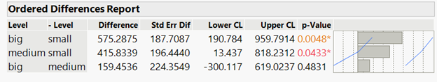

Q1: How do you read the chart on the right in the Ordered Differences Report?
A1: The way to read the Ordered Differences Report is to look at each row and examine the p-value.
  1. Using the Companies.jmp sample data set, the first row looks at the difference between big and small size companies profits.
  2. The null hypothesis is that there is no significant difference between big and small size companies profits.
  3. Given the p-value is less than 0.05 we reject the null hypothesis.
  4. And conclude that there is evidence to suggest a significant difference in profits between big and small companies.
  5. The difference is around $575M profits and we can be 95% sure the difference could be as low as $190M and as high as $959M
You follow a similar process for the second row medium and small companies – we can conclude there is also a significant difference in profits of around $413M between medium and small companies.
For the third row big and medium companies the p -value is greater than 0.05 therefore there is no evidence to suggest that the profits differ for big and medium companies.

Q2 : How do I link the histogram and blue lines to the p-values?
A2 : The [histogram] bar represent the size of the difference and the blue line is meant to indicate direction (positive or negative difference).
The larger the bar (difference) the smaller the p value. When the p-value is less than 0.05 then we consider it a statistically significant difference.

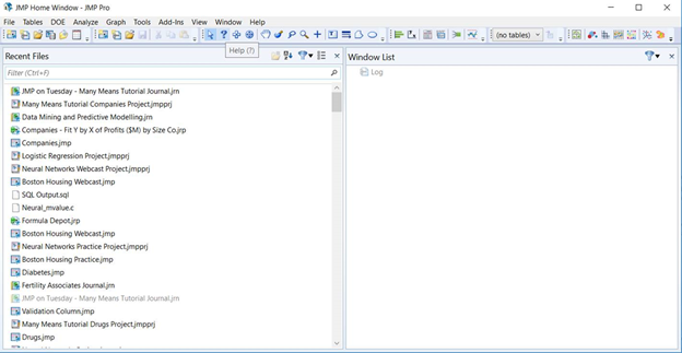

Note that you can select the Help Icon from the Tools Menu and drag it to any Report Output you like and JMP®15 will take you directly to the JMP online help.

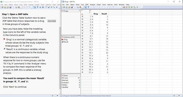

Q3: What was the DOE behind the drug dataset?  Is it a completely randomised design (CRD)?
A3: The data set Drugs.jmp was a sample data set that you can find under the
Help > Tutorials > Many Means Tutorial.
The information about the data set is limited to that it is made up of one continuous response variable and one categorical variable with three levels/types.

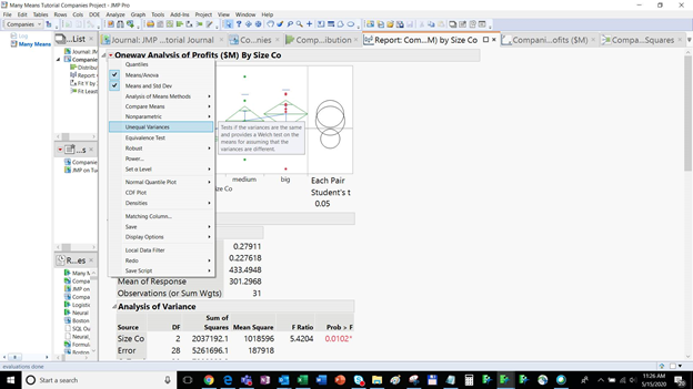

Q4: Can you use the ANOVA when raw data is not the same between groups?
A4: Yes, you can use the ANOVA test if the variation is different within groups. You may need to use the Unequal Variances test which provides a Welch test on the means and assumes the variances are different.

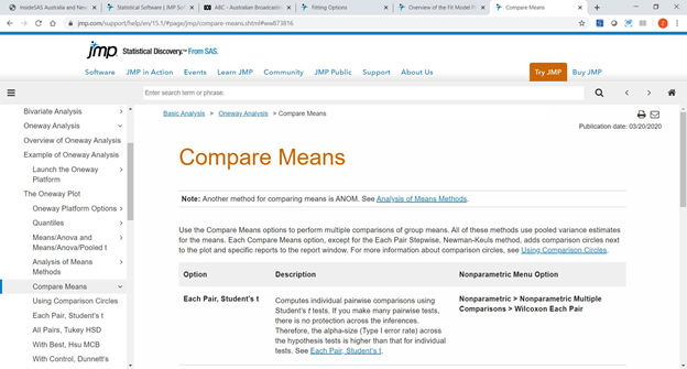

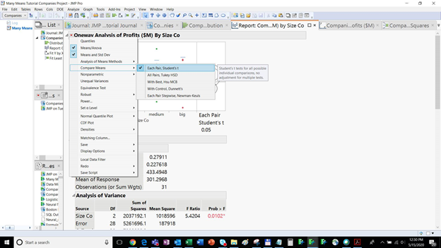

Q5 : May I ask what is the difference between 1. Each Pair, Student T and 2. All Pairs, Tukey HSD?
A5 : The Each Pair, Student T tests for all possible individual combinations, there is no adjustment for multiple tests. The All Pairs Tukey Honest Significant Different Tests protects the overall error rate and considers the sample size. Read more about the Compare Means for One Way ANOVA online at the JMP®15 Help Support page.
https://www.jmp.com/support/help/en/15.1/#page/jmp/compare-means.shtml#ww873816
Q6 : How to identify which pairs [groups] to use while using 'compare means'?
A6 : You can easily identify the group or pairs by selecting the circle in the Each Pair Test on the right hand side and this will identify the group in the chart.
Q7 : Do we need to check assumption of Homogeneity of Variance when using one way ANOVA??
A7 : One-way ANOVA can only be used when investigating a single factor and a single dependent variable. When comparing the means of three or more groups, it can tell us if at least one pair of means is significantly different, but it can’t tell us which pair. Also, it requires that the dependent variable be normally distributed in each of the groups and that the variability within groups is similar across groups.
You can use the ANOVA test if the variation is different within groups. You may need to use the Unequal Variances test which provides a Welch test on the means and assumes the variances are different.
