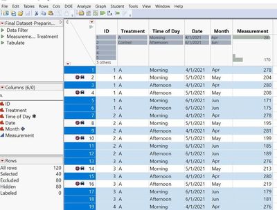

  • Use Value Ordering to define order of variables on all charts
  • Hide Rows
    • When you Hide rows, they are hidden in all plots, including all open plots
    • Hiding rows does not exclude them from calculations and analyses
  • Exclude Columns
    • Excluded columns are not considered in your analysis
    • Excluded columns remain visible in the data grid

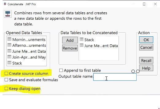

Tip: When preparing JMP data (join, concatenate, stack, split, etc.) check Keep Dialog Open. If you want to check your work, check Create Source Column to give info to help you during checking.  You can delete the Source Column from final table later.
Check Create Source Column to add column to table; check Keep Dialog Open in case you want to check your work.
Final Prepared Data Table
