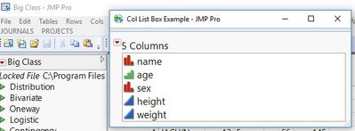

Names Default To Here( 1 );
New Window( "Col List Box Example",
	fontobj = lb = Filter Col Selector( width( 250 ) )
This results in this window:
So far so good, but where is my filter???

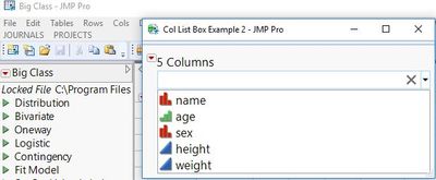

So using one of these commands you'll get the filter right after creating the window and somehow set it as default for your Filter Col Selector Window:
fontobj << Name Contains (" ");
Please be aware that you need to at least enter a space, otherwise the filter won't appear. This will be the result:
