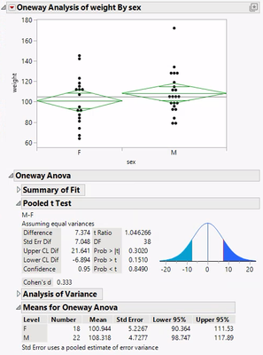

  1. From an open JMP® data table, select Analyze > Fit Y by X.
  2. Click on a continuous variable from Select Columns, and click Y, Response.
  3. Click on a two-level categorical variable and click X, Factor.
  4. Click OK. The Oneway Analysis output window will display.
  5. Click on the red triangle and select Means/Anova/Pooled t.
Some of the additions to the report include:
  • Mean diamonds (95% Confidence Intervals) added to the graph.
  • T-test Statistic and p-values for testing the hypotheses:
    H0: m1 = m 2 vs. HA: m 1 ≠ m 2 ; or HA: m 1 > m 2 ; or HA: m 1 < m 2
  • Confidence Interval for (m1 - m 2).
  • Individual Confidence Intervals for m1 and m 2.
Note: Means/Anova/Pooled t is the test under the assumption of equal variances.
For a test without the assumption of equal variances, select t Test under the red triangle instead.
Results
• Upper CL Dif and Lower CL Dif give the 95% CI for (μ1 - μ 2), the difference between the two population means. Here we estimate that difference to be (-6.89 , 21.64). Since the 95% CI contains zero, we conclude that there is not the statistical evidence needed to conclude a significant difference between the means.
• Prob > |t| is the p-value for the two-tailed test. The null hypothesis is that means are equal (the mean difference is zero). Since Prob > |t| is greater than 0.05, cannot reject the null hypothesis (i.e., we cannot conclude that there is a significant difference between the two population means).
• 95% Confidence Intervals for the Individual Means are shown in the Means for OneWay Anova table. We estimate, with 95% confidence, that the population mean Weight for Females to be between 90.4 and 111.5 and to be between 98.7 and 117.9 for Males.
