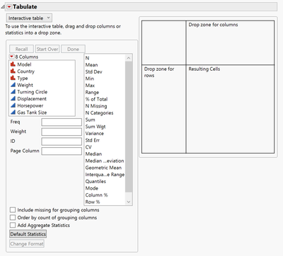

  • From an open JMP® data table select Analyze > Tabulate.
  • Drag and drop variables from the column list to the drop zone for rows and columns.

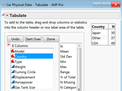

    • Country (below, left) is in the rows drop zone – the number of observations per country is displayed.

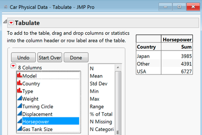

    • Horsepower (middle) is in the columns drop zone as an analysis column – the sum for horsepower is displayed for each country.

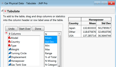

  • Drag and drop one or more summary statistics from the middle panel into the results area. Mean and Std Dev are displayed for each country (below, right).

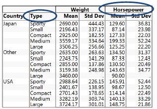

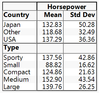

  • To add new summary panels to the table, drag and drop the new variable to the bottom or left of the table. Here, Type has been added to the bottom of the original table.
  • To add additional row or column variables, drag and drop a new variable on either side of the current variable in the table. Here, Type has been added next to Country and Horsepower has been added next to Weight.
