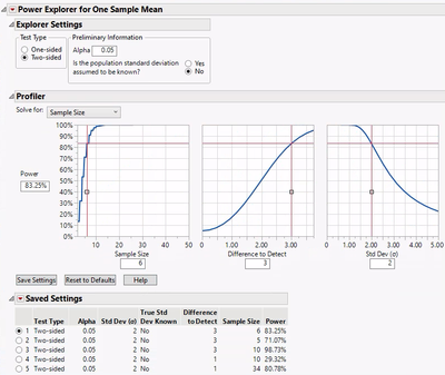

  1. Select DOE > Sample Size Explorers and choose Power > Power for One Sample Mean.
  1. Choose the type of test: One-Sided or Two-Sided and Alpha (significance level for the test). Here we consider the two-sided alternative hypothesis H0: m = m0 vs. HA: m ≠ m0
  2. Choose if standard deviation is known. If “Yes” analysis will be based on the Z-Test. If “No” analysis will be based on the t-Test.
  3. Enter a value for the Standard Deviation. Here we assume 2.0.
  4. Enter the Difference to Detect. This is the difference between a population mean under HA considered to be true from the value of the population mean under H0. Here we consider a difference of 3.0, which is 3.0/2.0 = 1.5 standard deviations from the value of the population mean under H0.

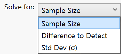

  5. Select parameter to solve for. Here we chose Sample Size.
  6. Enter a value for the Power. Here we entered 0.80. The solution (n=6) is shown in the Sample Size field.
    Note: The Power field changed to 83.25% since sample size can only be an integer. n=5 results in a Power of 71.1%.
  7. Use the interactive cross-hair tool (or type in values) for Power, Sample Size, Difference to Detect, and Std Dev to study the relationship between these parameters solving for many different scenarios.
The settings and solution for each analysis performed can be saved. The table of saved settings shows the results of five different analyses performed when testing the hypothesis H0: μ = μ0 vs. HA: μ ≠ μ0
1. What sample size is needed to achieve a power of 80% at detecting a difference of 3/2 = 1.5 std dev?
Answer: n = 6
2. What is the power with a sample size of 5 for the above scenario? Answer: Power = 71.1% 3. What is the power for a sample size  of 10 in the above scenario?
Answer: Power = 98.7%
4. What is the power for a sample size of 10 at detecting a difference of 1/2 = 0.5 std dev?
Answer: Power = 29.3%
5. What sample size is needed to achieve a power of 80% at detecting a .5 std dev difference?
Answer: n = 34
