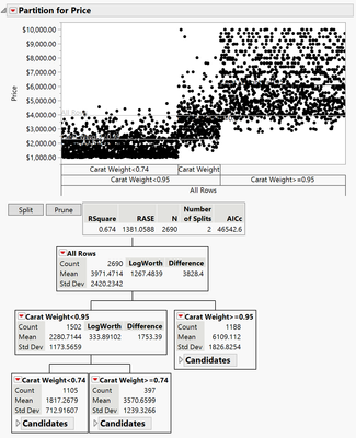

  1. From an open JMP® table, select Analyze > Predictive Modeling > Partition.
  2. Select a continuous response variable from Select Columns and click Y, Response.
  3. Select explanatory variables and click X, Factor.
  4. If desired, enter the Validation Portion or select a validation column and click Validation (JMP Pro only). A validation set was not used in this illustration.
  5. In JMP Pro only, select the tree Method: Decision Tree (the default), Bootstrap Forest, Boosted Tree, K Nearest Neighbors, or Naive Bayes.
  6. Click OK. JMP initially displays a graph of showing the response for all the observations and a line drawn at the overall mean ($3,971 in this example).
  7. Click the Split button. The original observations will be split into two nodes, or leaves. In the top graph, horizontal lines are drawn at the mean response within each leaf and vertical lines depict the leaf’s relative size.
  8. Click Split to make an additional split. Click Prune to remove a split. If a validation portion or validation column is used, click Go to perform automatic splitting and pruning optimizing the fit on the validation data.

Interpretation for the first two splits (Response is Diamond Price in $):
• There are 1,502 obs with Carat Weight < 0.95. The mean price of these obs is $2,281.
• There are 1,188 obs with Carat Weight >= 0.95. The mean price of these obs is $6,109.
• For the 1,502 obs in with Carat Weight <0.95, the second split, also based on the Carat Weight variable, is at a Carat Weight of 0.74.
