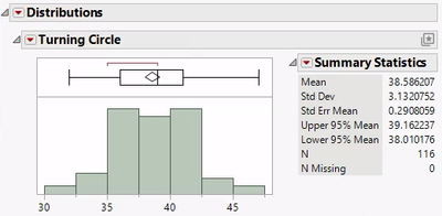

  1. From an open JMP® data table, select Analyze > Distribution.
  2. Select one or more continuous variables from Select Columns, click Y, Columns (continuous variables have blue triangles), and click OK
Car Physical Data.jmp (Help > Sample Data Folder)Car Physical Data.jmp (Help > Sample Data Folder)
The Upper 95% Mean and Lower 95% Mean shows the 95% confidence interval for the population mean.
Note: To change the confidence level, request a one-sided confidence limit or specify sigma, click on the red triangle for the variable, select Confidence Interval, and select the confidence level or click Other.

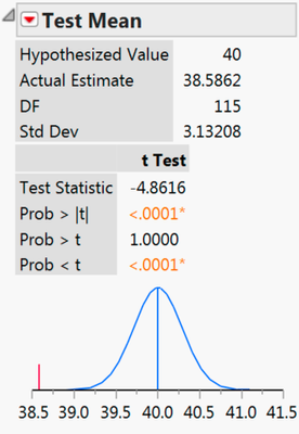

One Sample t-Test for the Mean
  1. From the Distributions report window (shown above), click on the red triangle for the variable and select Test Mean.
  2. Enter the hypothesized value under Specify Hypothesized Mean, and click OK. We will test the following hypothesis:
H0: m = 40 vs. HA: m ≠ 40. JMP will display:
  • The t-statistic.
  • P-values for the two-tailed and one-tailed tests.
  • A graph to aid in interpreting the p-values, showing the hypothesized mean (center of the curve) and the sample mean (red line).
Interpretation of p-values for this example (using a significance level of 0.05):
1. Prob > |t| is less than 0.05 - reject the null hypothesis that the true mean is 40. This is the two-tailed test. Conclude that the true mean is not 40.
2. Prob > t is greater than 0.05 - fail to reject the null hypothesis that the true mean is <= 40. This is a one-tailed test. There no statistical evidence to reject the null hypothesis.
3. Prob < t is less than 0.05 - reject the null hypothesis that the true mean is >= 40. Conclude that the true mean is less than 40. The confidence interval (38.0 , 39.2) provides an estimate of how different the population mean is from 40.
