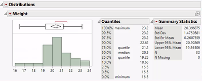

  1. From an open JMP data table, select Analyze > Distribution.
  2. Select one or more continuous variables from Select Columns, click Y, Columns (continuous variables have blue triangles), and click OK.

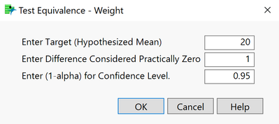

  3. From the Distributions report window, select Test Equivalence under the red triangle next to the variable name.
  4. Specify the Hypothesized Mean, the Confidence Level, and the difference from the hypothesized value considered practically zero (i.e., Margin of Equivalence). Click OK. Here we chose a hypothesized mean of 20,  95% Confidence Level, and a margin of equivalence of +/- 1.

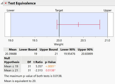

  • Rejecting the Null Hypothesis in favor of the Alternative is essentially concluding there is enough statistical evidence to believe the population mean is within +/- 1 of the hypothesized value. In other words, “Is Equivalent”.
  • The framework of an Equivalence Test reverses the roles of the Null and Alternative Hypothesis in a traditional hypothesis test for the mean where the hypotheses are:  H0: m = m0 vs. HA: m ≠ m0. In the traditional test, if the data does not produce enough statistical evidence to believe the Alterantive Hypothesis, it does  not mean that statistical evidence was produced to believe the Null Hypothesis. Instead, the data simply did not produce enough statistical evidence to reject it.

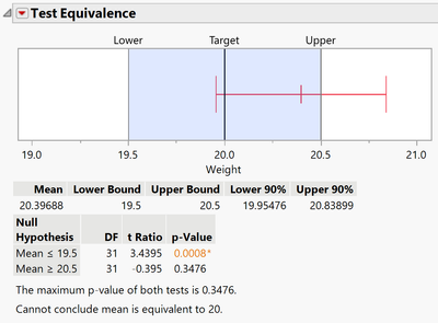

JMP will display a graph showing a (1 - 2a) Confidence Interval comparing it to the Margin of Equivalence, and two separate one-sided t-tests. The Null hypothesis is rejcted in favor of the Alternarive when the largest p-value is less than a. When this is the case, the (1 - 2a) Confidence Interval will be completely within the Margin of Equivalence.
Coating.jmp (Help > Sample Data Folder > Quality Control)Coating.jmp (Help > Sample Data Folder > Quality Control)
Results with a Margin of Equivalence of +/- 1Results with a Margin of Equivalence of +/- 1
Results with a Margin of Equivalence of +/- 0.5Results with a Margin of Equivalence of +/- 0.5
• In the first analysis (Margin of Equivalence of +/- 1), the statistical evidence was produced to conclude equivalence.
• In the second analysis (Margin of Equivalence of +/- 0.5), the statistical evidence was NOT produced to conclude equivalence.
