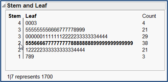

Stem and Leaf report created by clicking the red triangle for the variable and select Stem and Leaf.Stem and Leaf report created by clicking the red triangle for the variable and select Stem and Leaf.
Stem and Leaf Tips:
  • A key to interpret the values is at the bottom of the plot. The bottom three values are 1700, 1800, 1900. The top 4 values in this example is 4000, 4000, 4000, 4300 (Note: values have been rounded to the nearest 100).
  • Click on values in the stem and leaf plot to select observations in both the histogram and the data table. Or, select bars in the histogram to select values in the stem and leaf plot and data table.
