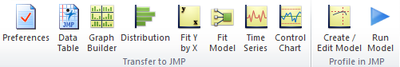

This JMP ribbon will be accessible in Excel. You may need to click on the JMP tab for the JMP ribbon to appear.
JMP Menu ribbonJMP Menu ribbon
  1. Preferences: Use to specify
  • The name to use for the JMP data table;
  • Whether to use the first row as column names (checked by default);
  • The number of rows to use for column name (up to four can be used);
  • Whether to transfer hidden rows and/or columns.

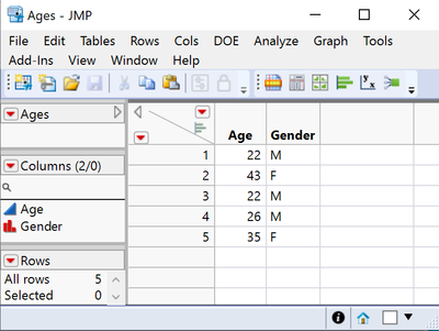

  1. Data Table: Send selected data to JMP. A JMP data table will be created containing the selected data.
Selected dataSelected data
Selected data sent to JMP tableSelected data sent to JMP table
Tips:
• If the data table does not automatically display, bring JMP to the foreground.
• Review the moeling types in JMP – variables will be assigned either Continuous or Nominal modeling types.
• JMP will recognize dates and other Excel formats.
  1. Graph Builder: Send selected data to JMP and launch the Graph Builder. Interactively create graphs, including line plots, splines, box plots, bar charts, histograms, mosaic plots and geographic maps.
  2. Analysis Platforms (Distribution, Fit Y by X, Fit Model, Time Series, Control Charts:( Sends selected data to JMP and launches the chosen platform.
