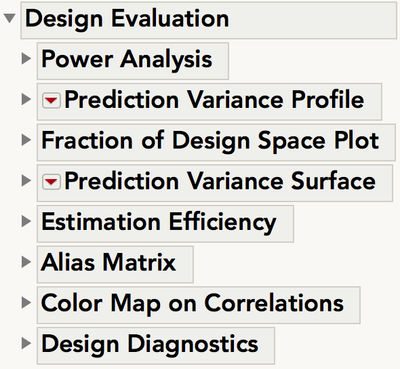

The Design Evaluation outline provides a number of tools to assess design properties, including:

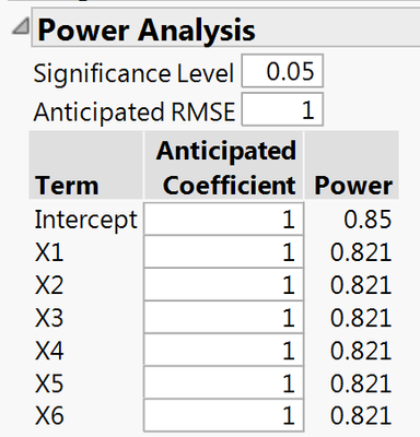

  • Power analysis for exploring effects of given sizes

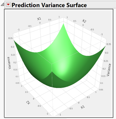

  • Prediction variance profile and surface

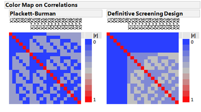

  • Alias matrix and color map of correlations
  • Measures of estimation and design efficiency
Note: You can also modify the assumed model to further explore aliasing of effects.

The Compare Designs platform compares two or three designs simultaneously to explore and evaluate their performance. This allows you to select the design that best meets your requirements and budget.
  1. With Plackett-Burman.jmp as the active window, select DOE > Design Diagnostics > Compare Designs.
  2. Select Definitive Screening Design to compare properties of these two designs, and click OK.
  3. If desired, change the terms in the assumed model and in the alias terms list.
  4. Explore the many different performance metrics in the Design Evaluation outline including Power, Estimation Efficiency, Correlation between effects, et al.
