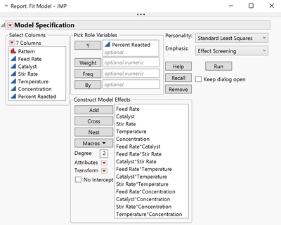

  1. From an open JMP® table (for a completed full factorial experiment) select Analyze > Fit Model.
    Note: The Fit Model platform can also be accessed from the Model script saved to the data table made when the Designed Experiment was created.
  2. In the Model Specification window:
  • Click on the response under Select Columns, and click Y (under Pick Role Variables).
  • Select the factors of interest. Under Macros, select Full Factorial (with Degree = 2) to enter all 5 main effects and all 10 2-way interactions into the model.
  • To remove higher-order interactions, select the interactions under Construct Model Effects and hit Remove.

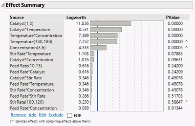

  1. Click Run. JMP will display the following results:
  • The Actual by Predicted plot.
  • The Effect Summary (shown).

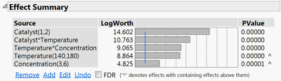

  1. To reduce the model, remove non-significant terms bottom-up. To remove a term:
  • In the Effect Summary, select the least significant term(s).
  • Click Remove.
  • Effect Heredity: Keep lower-order components with containing effects above them (indicated by ‘^’ in the right-most column).
  • Repeat until the model has been reduced.

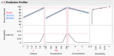

  • Use the Prediction Profiler to explore the model, to optimize, and/or to simulate response values.
  • Surface and Contour Profiler, and Interaction Plots are other graphs available to visualize the results.
