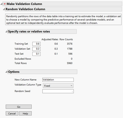

  1. From an open JMP data table, select Analyze > Predictive Modeling > Make Validation Column.
  2. Stratification, Grouping, and Cutpoint columns can be used to tailor the partitioning. If a simple validation column is desired, Click OK.
  3. In the resulting window, enter values (counts or proportions) indicating how the data will be allocated to the training, validation and test sets. Choose a Random Seed in order to reproduce the same random assignment if desired. Click OK. A new column is created, populated with the values 0, 1, and 2 in the proportions (or counts) specified.
• 3,576 (60%) of the observations (Training set) will be used to build (train) the model.
• 1,758 (30%) of the observations (Validation set) will be used to validate and select the best model.
• 596 (10%) of the observations (Test set) will be used to test the chosen model’s performance on new data.

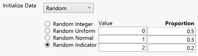

  1. From an open JMP data table, select New Column from the Cols menu.
  2. In the resulting New Column window, change the Column Name to Validation.
  3. Next to Initialize Data, click on the arrow and select Random.
  4. Select Random Indicator. Type in the desired proportions. Here we chose 50% 0s (train), 30% 1s (validate) and 20% 2s (test).

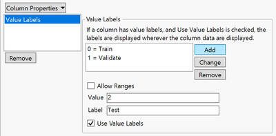

  5. To display the labels Train, Validate and Test rather than 0, 1 and 2, right click on the column and select Column Properties > Value Labels Enter the value and the desired label and click Add one value at a time.
  6. Click Apply to view the new column in the data table (to verify that the column will be created as desired). Then click OK to create the column.
