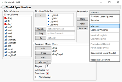

  1. From an open JMP® data table, select Analyze > Fit Model.  Select Manova from the Personality drop-down menu.
  2. Add the responses:  From Select Columns, select the continuous response variables (continuous variables have blue triangles), and click Y.
  3. Add model effects:  Select variables and click Add (under Construct Model Effects). To specify an interaction term, select multiple columns, then click Cross. Click Run
  4. In the resulting window, select Repeated Measures from the Choose Response drop-down menu.
  5. Accept the defaults, then click OK.

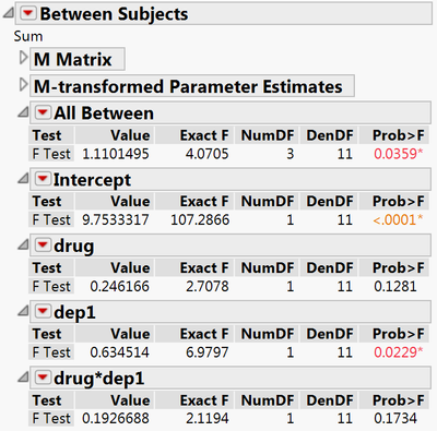

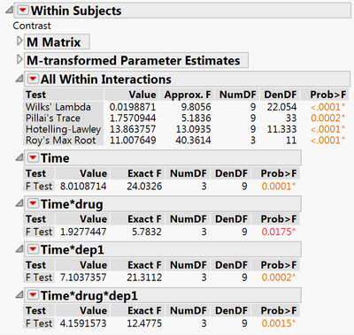

By default, JMP will display the Parameter Estimates, Least Squares Means, Between Subjects and Within Subjects results and more. Additional options are available under the red triangles.
  • Within Subjects results include the multivariate significance tests for the differences over time for both the whole model and each effect.
  • Between Subjects results include the multivariate significance tests for the differences in the repeated measures across subjects for both the whole model and each effect.
