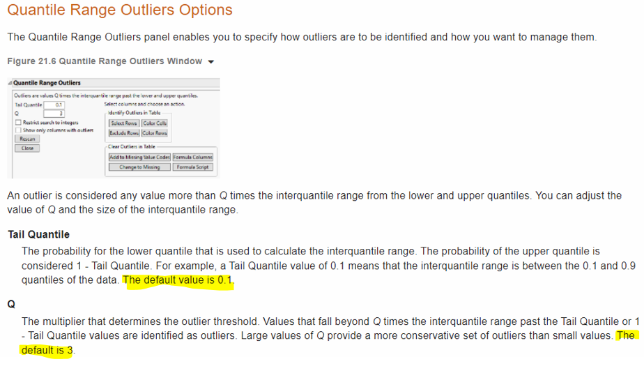

Is there some rationale that we can point to for why the default values for Tail Quantile and Q, are 0.1, and 3, respectively?
From the JMP 16 Online Help Documentation: https://www.jmp.com/support/help/en/16.2/#page/jmp/quantile-range-outliers.shtml

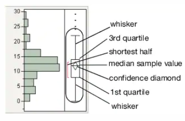

Classically we know that values that fall beyond Q = 1.5 times the interquartile range past the Tail Quantile (or 1 minus the Tail Quantile) are identified as outliers, where the Tail Quantile is = 0.25 on the upper bound and 1 - 0.25 = 0.75 on the lower bound.  This is the basis for the Outlier Box Plot:
