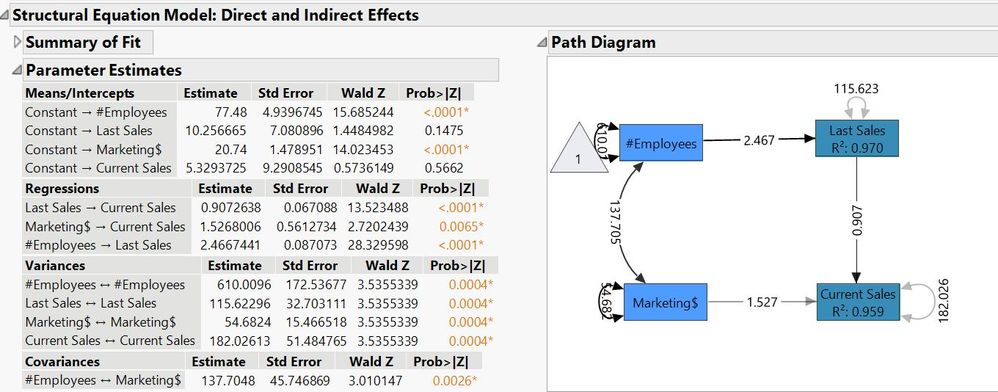

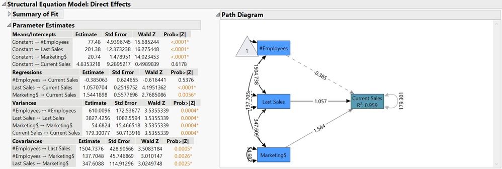

Q: Are indirect effects available?
A: Total and indirect effects with significance values will be available in 16.1, due to released 3Q.
Path Analysis SEM Direct and Indirect Effects.JPGPath Analysus SEM Direct Effects.JPG
