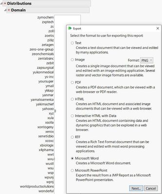

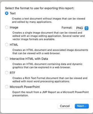

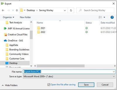

Q: How is Export different than Save As?
A: On the Mac, EXPORT saves to different formats and on the Mac you add the appropriate third party or JMP file extensions. On the PC, SAVE AS and EXPORT are two different interfaces to save to third party or JMP files.
Mac Export MenuMac Export MenuMac Export Menu
PC Export Menu 1PC Export Menu 1PC Export Menu 1
PC Export Menu 2PC Export Menu 2PC Export Menu 2

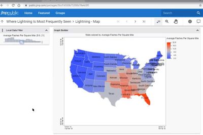

Q: What is JMP Public and JMP Live?
A: JMP Public is a great platform for sharing JMP data, reports and dashboards.  You can use interctive data filters on JMP Public or JMP Live servers.  Access to our JMP Public server is free. All you need is an account and some JMP reports to share. JMP Public stores all of your reports in one location and lets you maintain up-to-date reports for anyone to access. Because it is a public server, JMP Public is designed for information that is not confidential.  For confidential information, consider licensing JMP Live, a separate software product from JMP. JMP Live is the technology behind JMP Public.
 JMP Public Map with Interactive Local Data FilterJMP Public Map with Interactive Local Data FilterJMP Public Map with Interactive Local Data Filter
See Bill's short video on how to use JMP Public and how to create a free account to post reports to JMP Public.
