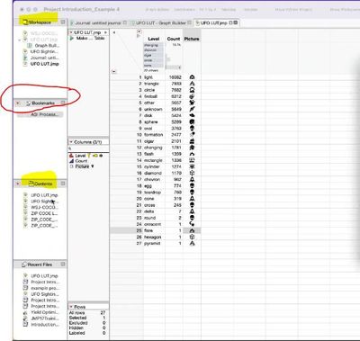

A: It depends.  Everything in the Project is independent in the Project and changes are not made to the original files. If you have a Bookmark pointing to a file, however, the work in the Project is occurring on the original source file on the desktop. Files dropped into Contents are copies living in the Project file.
Workspace, Bookmarks, Content windowsWorkspace, Bookmarks, Content windowsWorkspace, Bookmarks, Content windows

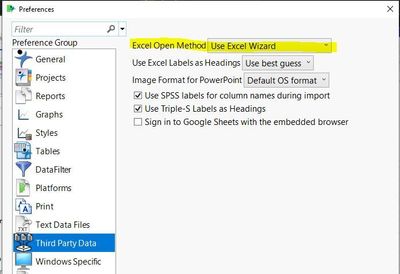

Q: How do you open Excel file from a Project?
A: After you bring it in and launch it, the Excel Import Wizard will launch if your third-Party Preferences are set to open Excel Import Wizard for Excel files.  See below. You can also, from the Project, File>Open and choose an Excel file.
Excel Import PreferencesExcel Import PreferencesExcel Import Preferences

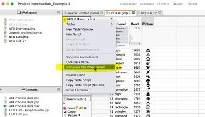

Q: Does it make sense to Save files to the Project, and delete from elsewhere on hard drive to clean up file area?
A: Yes, and consider organizing using Folders. See below. To further compress files, consider using the red triangle> Compress Files When Saved Option.
Compress File When Saved red triangle optionCompress File When Saved red triangle optionCompress File When Saved red triangle option

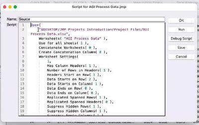

Q: Does it make sense to use Bookmarks for Excel or .csv files that others update regularly?
A: Yes.  Alternately, you can bring it into JMP when the Source file has a path to the original file.
Source File that points to updated fileSource File that points to updated fileSource File that points to updated file
