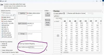

Q: If my workflow generates a NEW table in the process, and that new table then gets called by successive steps, I encounter issues with this because the newly formed table will be given a hard-to-predict name, like “untitled 5.” Can this step be “generalized” in a similar way?
A: The place where you will run into it especially is when you are using things in the Tables menu like stack and split and transpose, and the things that you make with stack, split, transpose. Unless you give them an explicit name, they will be called u=Untitled 17 or Untitled 32. So, name the new Output Table during the Tables menu operations.
Renamed split tableRenamed split table
