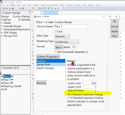

Q: Does JMP do pseudo-coding under the hood, or do you need to specify that somewhere?
A: JMP does it.  From Column Info, you can specify the type of psuedo-coding.  If you are analyzing an experiment that has not been done in JMP, you will need to make sure the column properties are set.

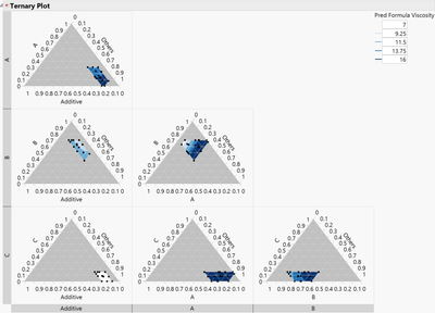

Q: How do you visualize mixture design spaces with more than three components?
A: These are commonly visualized with ternary plots with two of the three vertices representing individual components and the third vertices representing the sum of all other components.  Here is an example of the Lubricant Formulation experiment that is in Strategies for Formulations Development, A Step-by-Step Guide Using JMP (Snee and Hoerl, 2016).  Look at the first ternary plot at the top, Others = % Acid B + % Acid C.
Ternary Plot Example Snee and HoerlTernary Plot Example Snee and HoerlTernary Plot Example Snee and Hoerl
Here is a short video that explains how to visualize design spaces for mixtures with more than three components.
