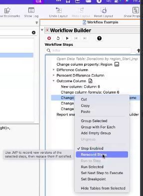

Q: Can I edit the Workflow?
A: Yes, you can edit the JSL.  And, you can rerecord any step in the Workflow.
Rerecord Workflow stepsRerecord Workflow steps

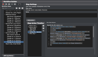

@MikeD_Anderson This is great!  I wasn't aware of Workflow Builder until I came across this.  Would you mind posting the JSL code you reference in the 22nd minute of the video that is used in the custom action that puts the arrow heads next to the row numbers?
Hey, @Judah!
I think this is the one that you want.  It goes here:
Here's the code that goes in that step:
For Each Row(Current Data Table(),
	r = Row();
	If(
		Is Missing(:Outcome), Current Data Table() << Select Rows( r ) << Markers( "FilledCircle" ),
		:Outcome == 1, Current Data Table() << Select Rows( r ) << Markers( "Filled Right Triangle" ),
		:Outcome == -1, Current Data Table() << Select Rows( r ) << Markers( "Filled Left Triangle" )
	Current Data Table() << Clear Select();
